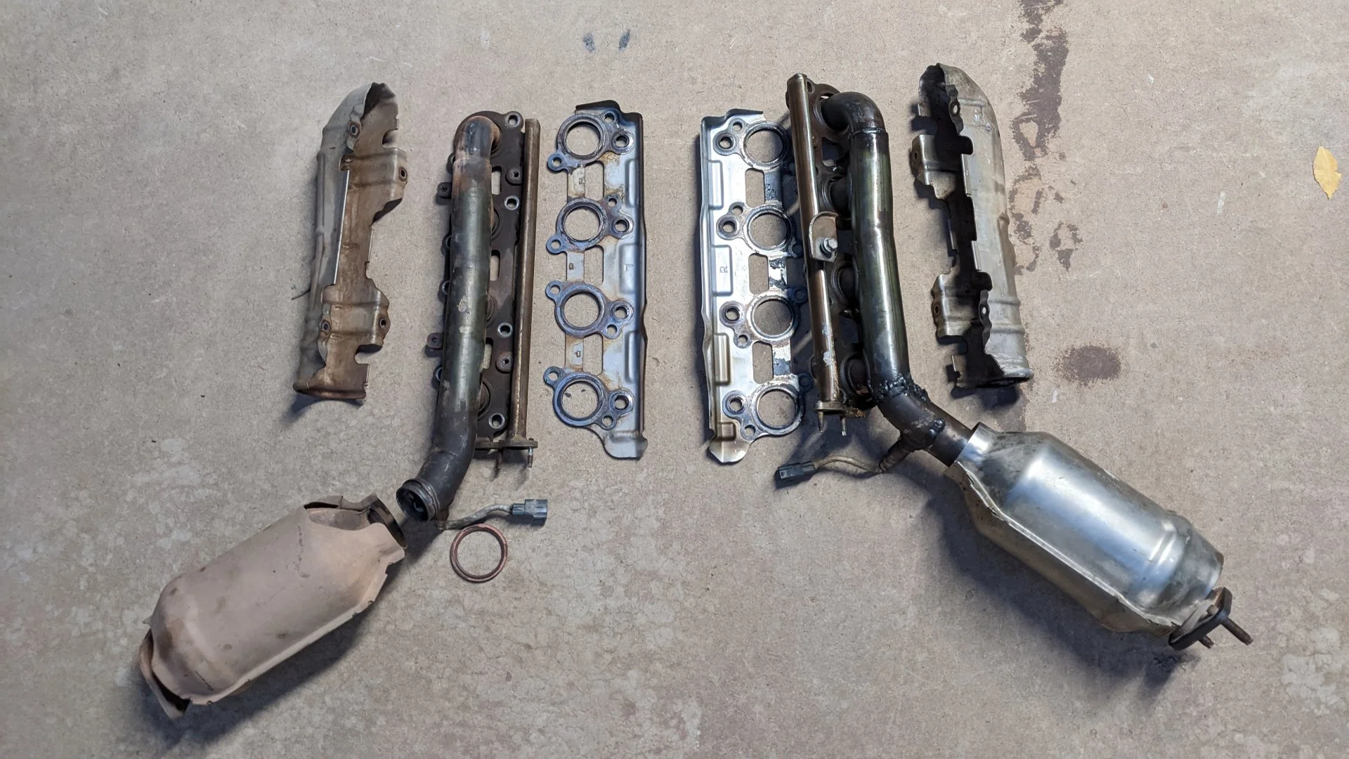

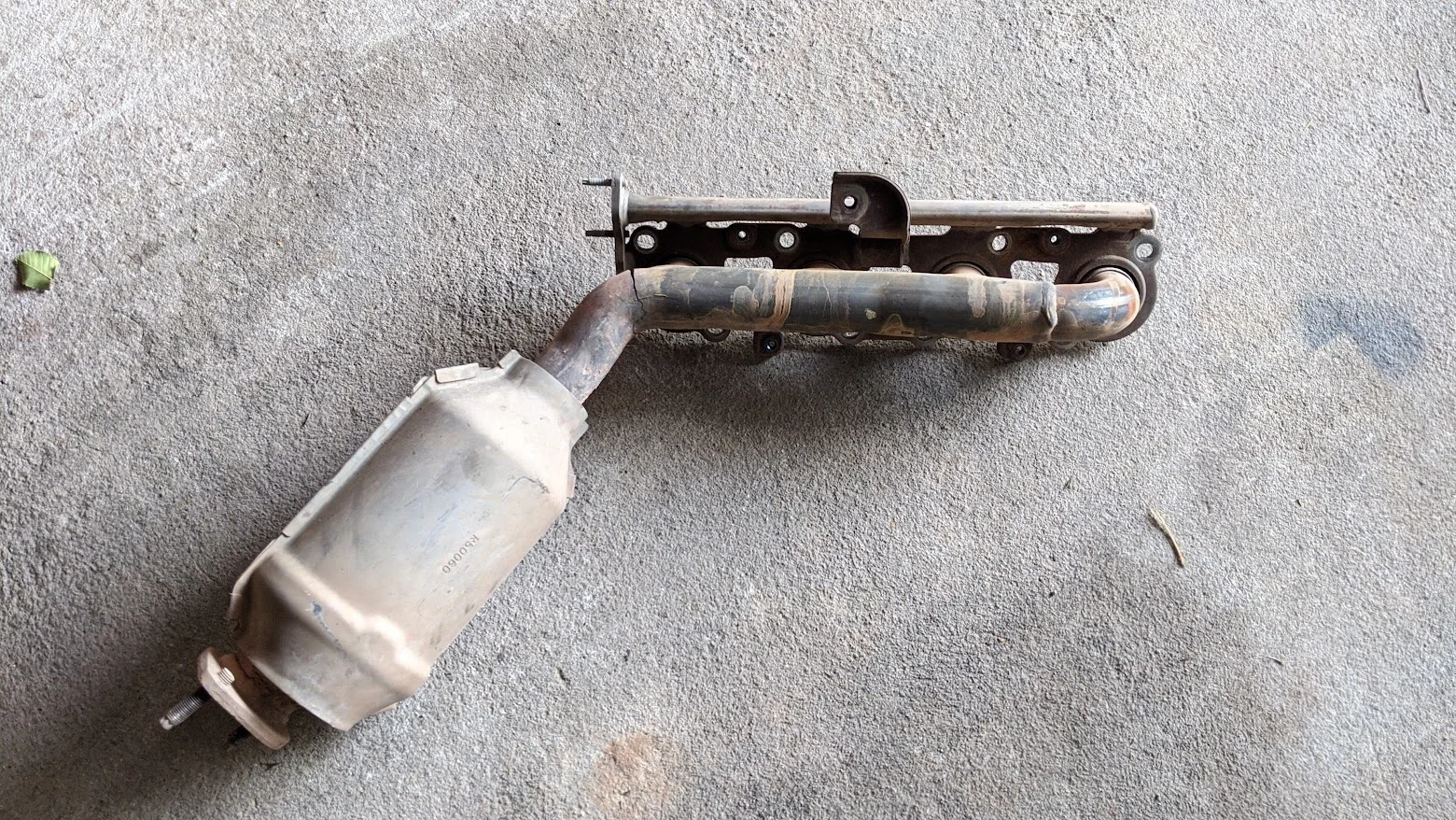

Speaking from experience of dealer replacement then failure in 14 months, some bandaids and ultimately bilateral manifold failure.......
Yep, pretty sure they all failed in the same way.

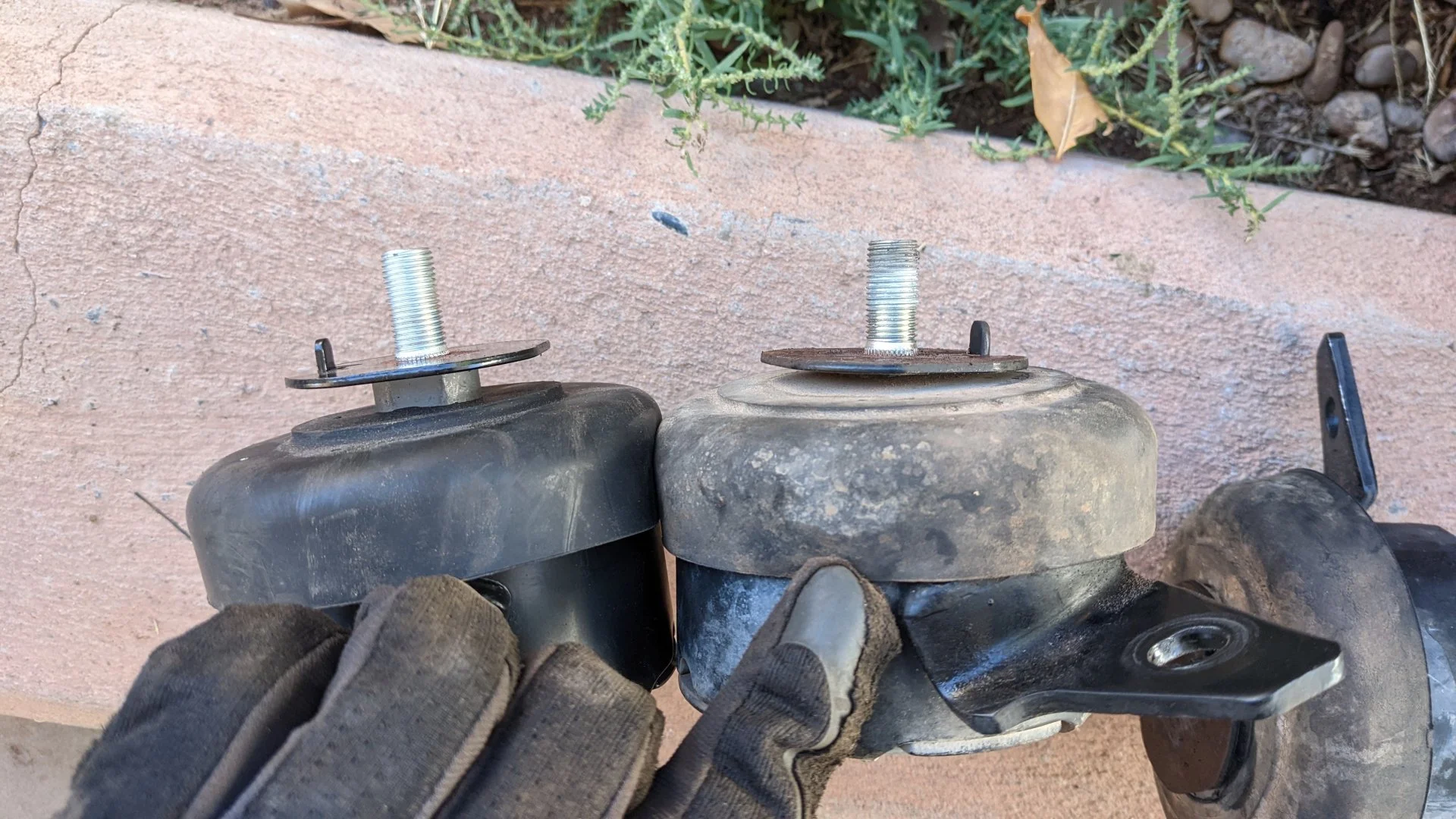

Check your engine mounts, they may be packed out and crushed.
Check your exhaust hanger isolators too, a snapped one can add extra pressure on the system lending to the failure on the bend of the rail....
I ultimately went Doug Thorley shorties, but those tips would be my recommendation for other fixes when going with stock manifolds.
