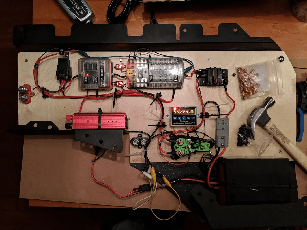

I think solar is on the short list for purchase. Here's a pic of my setup. Still some room for a solar controller.
- Ignition controlled fuse block and relay
- Coach/lfe fuse block
- Battery isolation manager for LFE batteries
- Adjustable thermostat to cut BIM charging below 0 celcius
- 30AH LFE (lower right corner)
- Crappy inverter
- Crappy inverter

Thanks for the details - this is very similar to the direction that I want to go. See you have a Wits End rear quarter panel mount. Will the original panel cover fit over this set up? Also, which 30ah battery are you using? Thanks!
Randomly came across this thread looking for thoughts on a lfe house battery (bigger than my fridge batt to sit in the #2 hdj battery position since I converted to 12v starter). So the 30ah fridge battery continues to be a champ, and after all this time I still get the satisfying clunk of the charging solenoid every time I drive. Still no DC DC converter, just direct 14v charge from the vehicle through the solenoid. This has been one of the more reliable diy projects I've made. Lfe ftw. I did add a solar panel and controller, and the fridge now lasts indefinitely.
