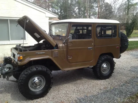

Opinions on the best battery for a '78 FJ40? Thanks!

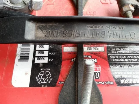

I've got an optima red top, its a winner every time...sooo did you....?
What size did you put in yours? I keep getting different answers on this....24/27 come up most often.
