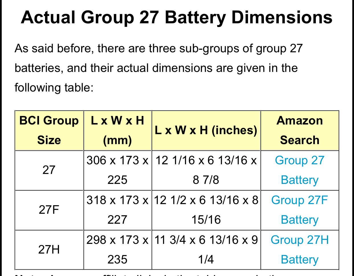

Problem: bought two 27 sized batteries, yes one is an F. They fit perfectly in the "box," yet the positive and negative cables do not reach on the right battery's (facing the truck) terminals. I have yet to put the left one in.
I pulled the right box out with the idea of cutting off the the back part (already did some), but to no avail.
Thoughts?

These are the batteries I bought. The 27F has a second set of terminals. Problem with the 27F side is the cables are not reaching the primary terminals by roughly 1.75 +/- inches.
I see that the 27 (starting looks it's mounted perpendicular to the front of the truck(?)
