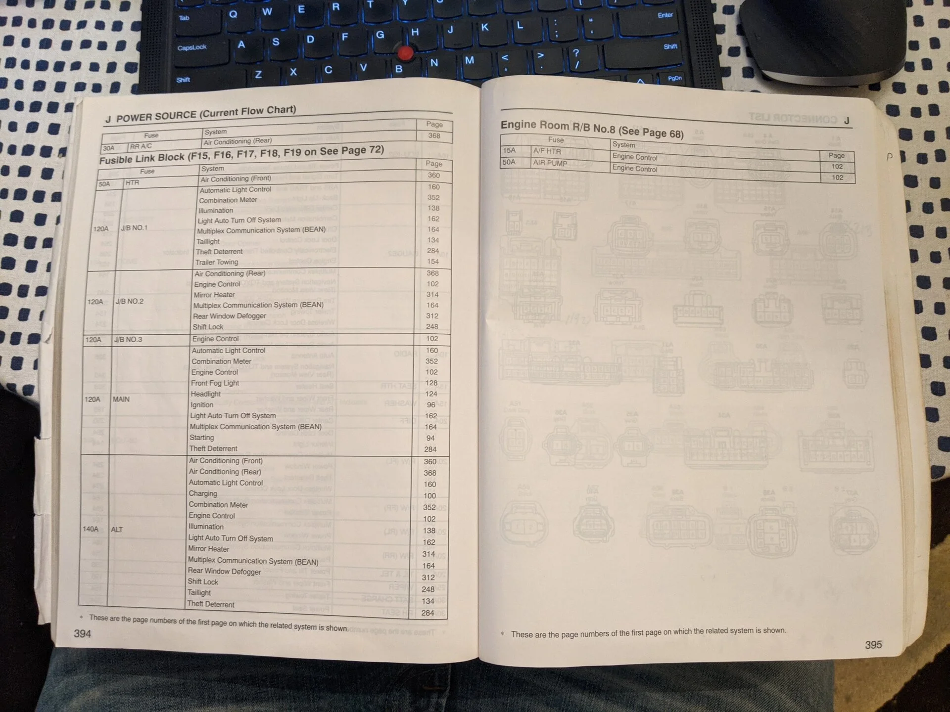

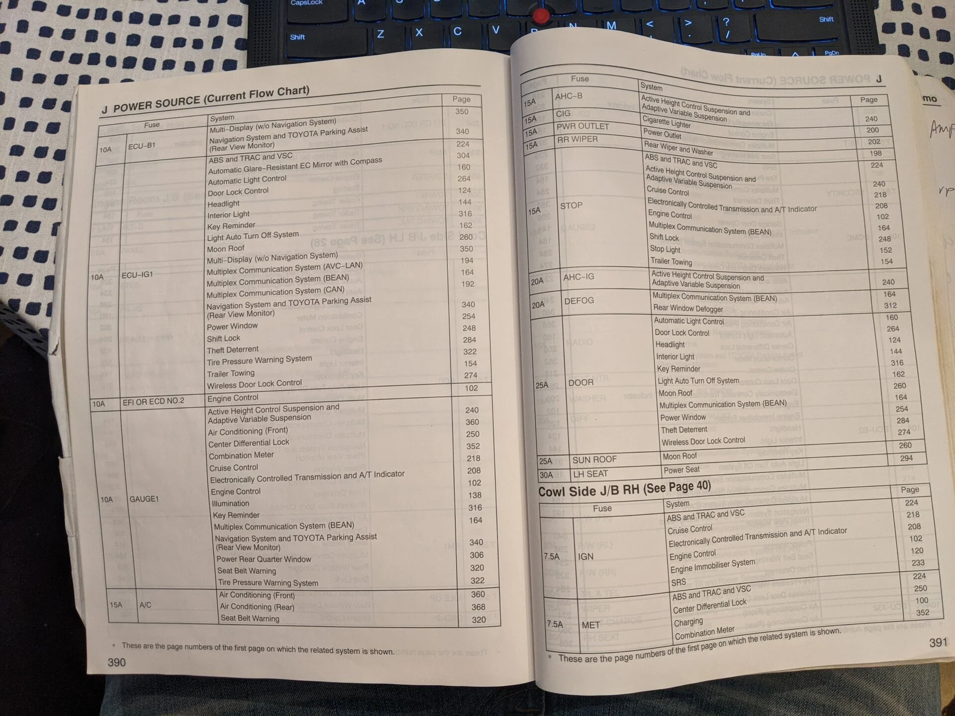

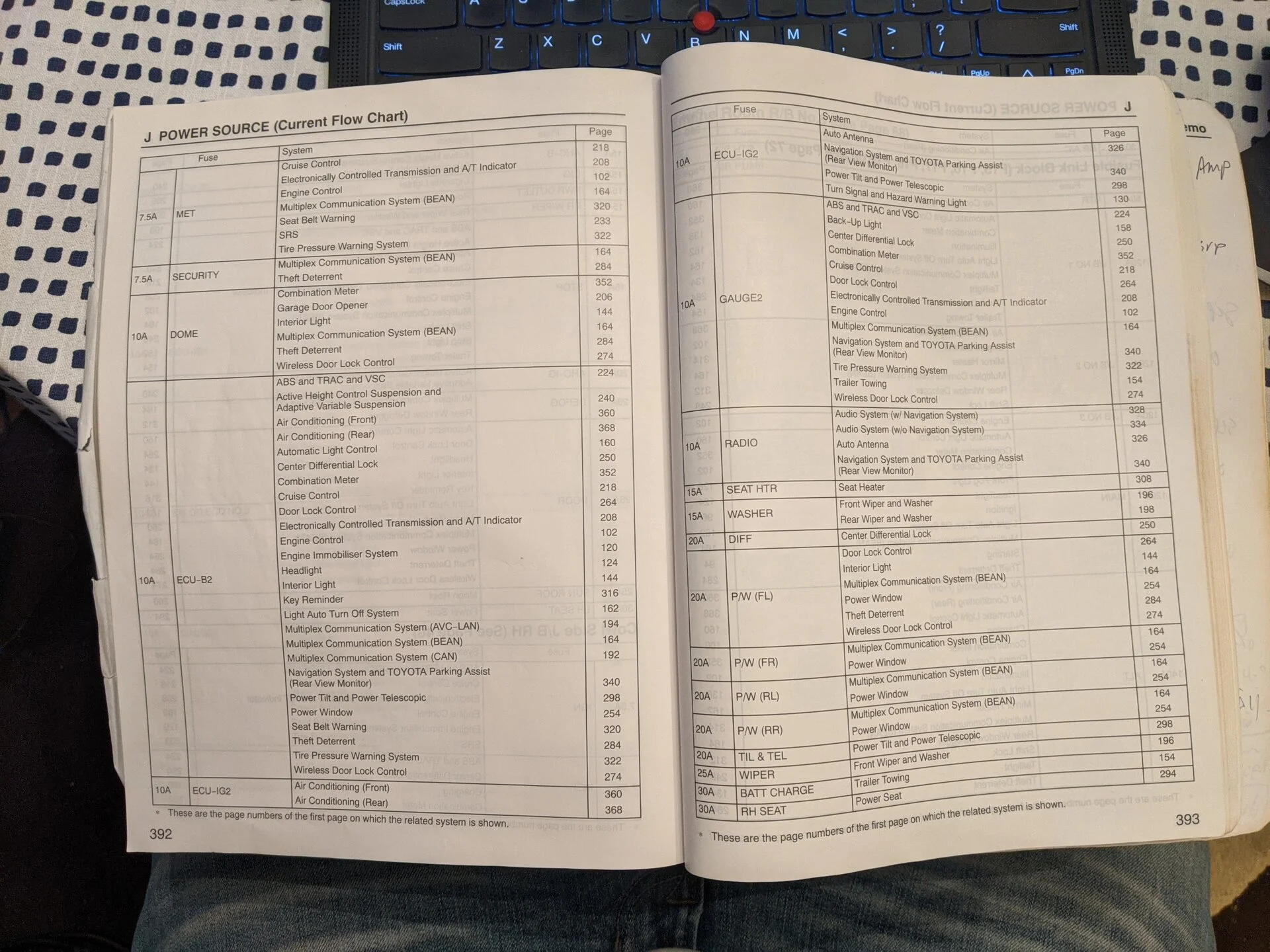

leave the doors and hood open. Wait til it sleeps, give away is that the door open indicator goes out after 20 minutes.
Then you could start measuring. Me, I'd pull anything related to port installed, DVD/NAV ECU drive, anything under the passenger front seat, DOME, etc, take your pick. SIngle battery- 24f, 06/7 should last 40-60 days at the airport and still crank above 10.25vdc
Set the multi-meter to lowest DC V setting. Once all modules have gone to sleep, check for any voltage reading across any fuse. Place the two terminals of the volt meter on two pins in each fuse (while plugged in). If you see one or more mV readings, then that fuse is feeding power to a module leading to parasitic draw.
