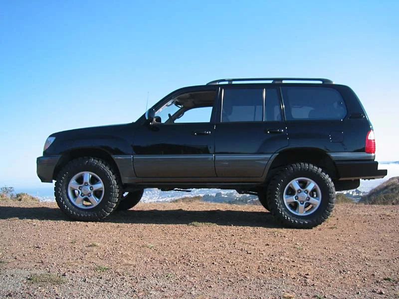

Now I love the look of this…
attachment.php

One of the main reasons I got this vehicle was its ability to haul gear and people over many different terrains and do it comfortably, I don’t want to screw that up. TO me Toyota has done a great job, but can it be improved? So should I lift it and if so what springs will not damage the ride and still be stable at 90+ MPH? Plus if you have ever visited Mexico you know they love hidden speed bumps in the middle of highways so I don’t want to break my back on every one.
So I have been thinking about a Dakar/Baja set up, soft but controlled, lifted but stable. Sorry for the long post but my situation is a little unique and I am concerned to lift it and not be able to run at the high speeds, plus I really have no need for MT's but maybe AT's?

A little bit of both. Though the lift in and of itself may not assist you, I do prefer the ride of OME suspension, and you may appreciate that on some of the more interesting Mexican roads; but truth is the poshy/sway'y ride the LC100 will likely be just fine.
It does sure look nice though with a mild lift and some mildly-aggressive tires, no?

True... Like I mentioned earlier I love the lifted LC's but is it really the right way to go with a car that sees 50% highway and 50% backroads...
OME t-bars and rear springs - Good quality springs at affordable prices
285 AT tires - Good size, selection, availability. My AT's handle better in every way than the stock tires did. Make sure you get a LT tire, they are tougher.
Custom shocks and mounts - The only way to get HIGH quality shocks
I can recommend a few shops in the San Diego or LA/OC area that can do custom fabrication for you. I like the Racerunner product line. They are high quality, rebuildable, and custom valving. They are also a good value compared to some other high end brands.
Personally, what I'd like to do is run Racerunner 2.5" reservoir shocks in front (6" travel) and Racerunner 2.5" reservior shocks in rear (10" travel). A good shop can take measurements and fabricate appropriate mounts for your application and make sure your suspension cycles properly.
I can't afford this setup right now so I'm working on Bilstein 5150's that will use the stock mounting position.
Hope this helps.
