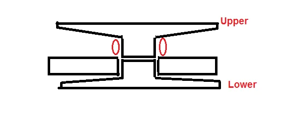

Alright I believe I have solved the issue.
Last night I took another look and identified that the lower-inner retaining washer (with the lip) is almost flush with the upper face of the shock mount. However, it does not stick out past the upper face of the shock mount (about .020 in shy--this is good). So therefore the upper-inner retaining washer (also has a lip) is causing the gap. I circled the gap in red ovals in the attached picture.
So with that, no matter how much you would tighten the top nut, the rattle is not improved.
I felt the lower-inner washer was sufficient to locate the shock in the mounting hole. Therefore, I cut off the lip of the upper-inner washer. This allowed it to be flush with the upper face of the shock mount, removing the gap. I then tightened the top nut to 60 ft-lb, a little bit more than the 51 ft-lb in the FSM.
On the way to work today, I did not detect any rattle noise.
