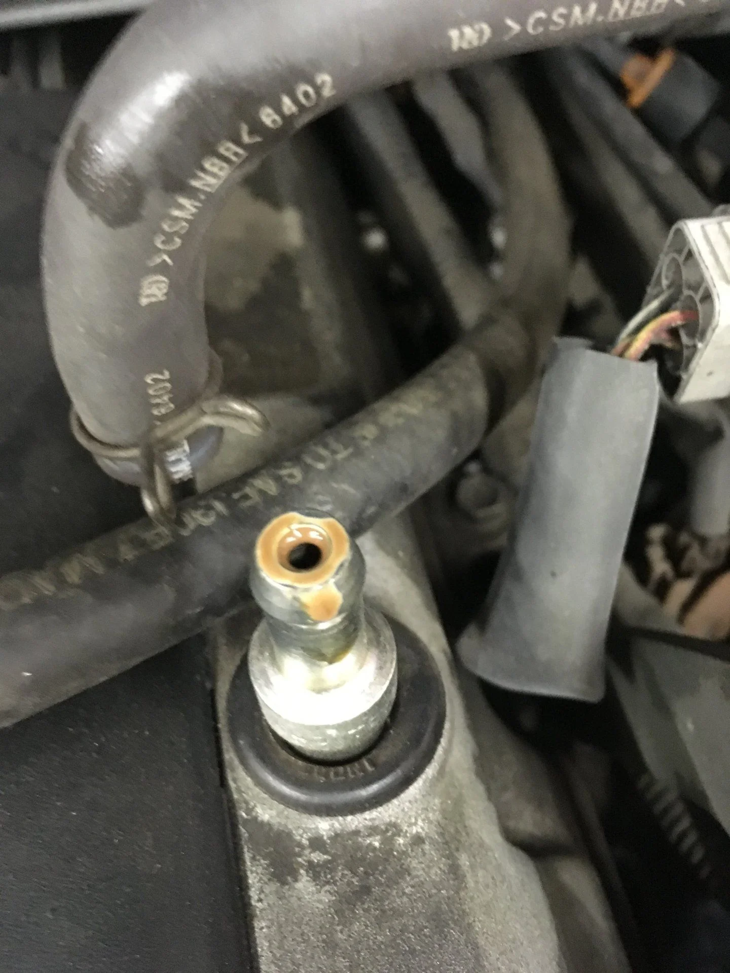

Also I checked the PCV valve (which I replaced not to long ago with OEM). I attached a picture, should this be cause for concern? I have the supercharger and it is routed in the stock configuration. I read this thread a couple weeks ago
https://forum.ih8mud.com/threads/pcv-system-with-the-trd-supercharger.916893/
Could I have screwed something up pushing it too hard with the stock PCV configuration? It has been run like this for the last 30,000 miles

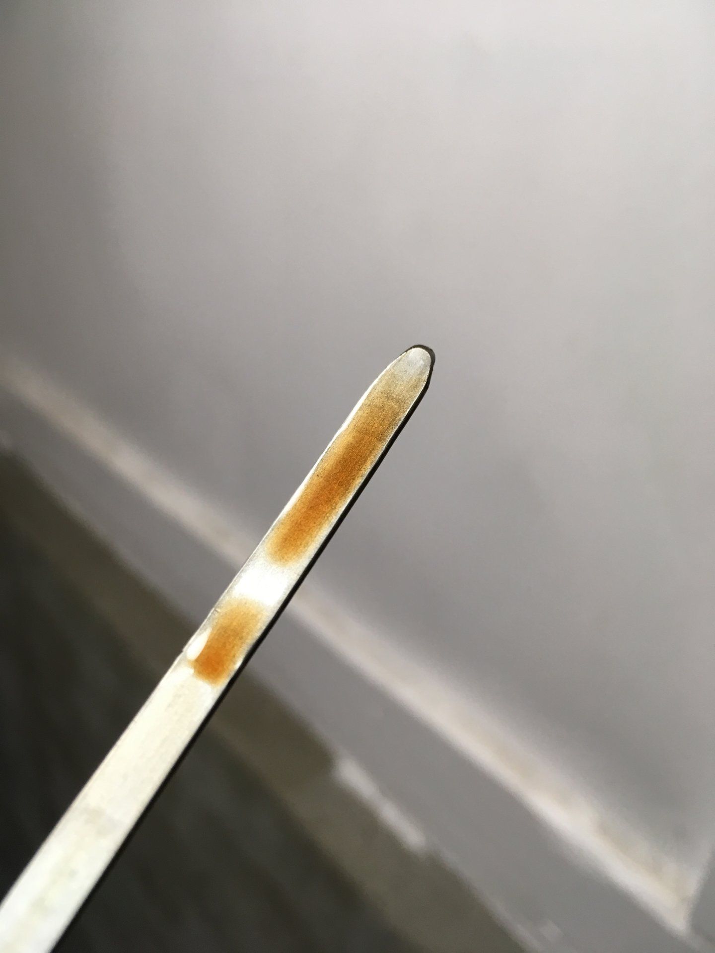

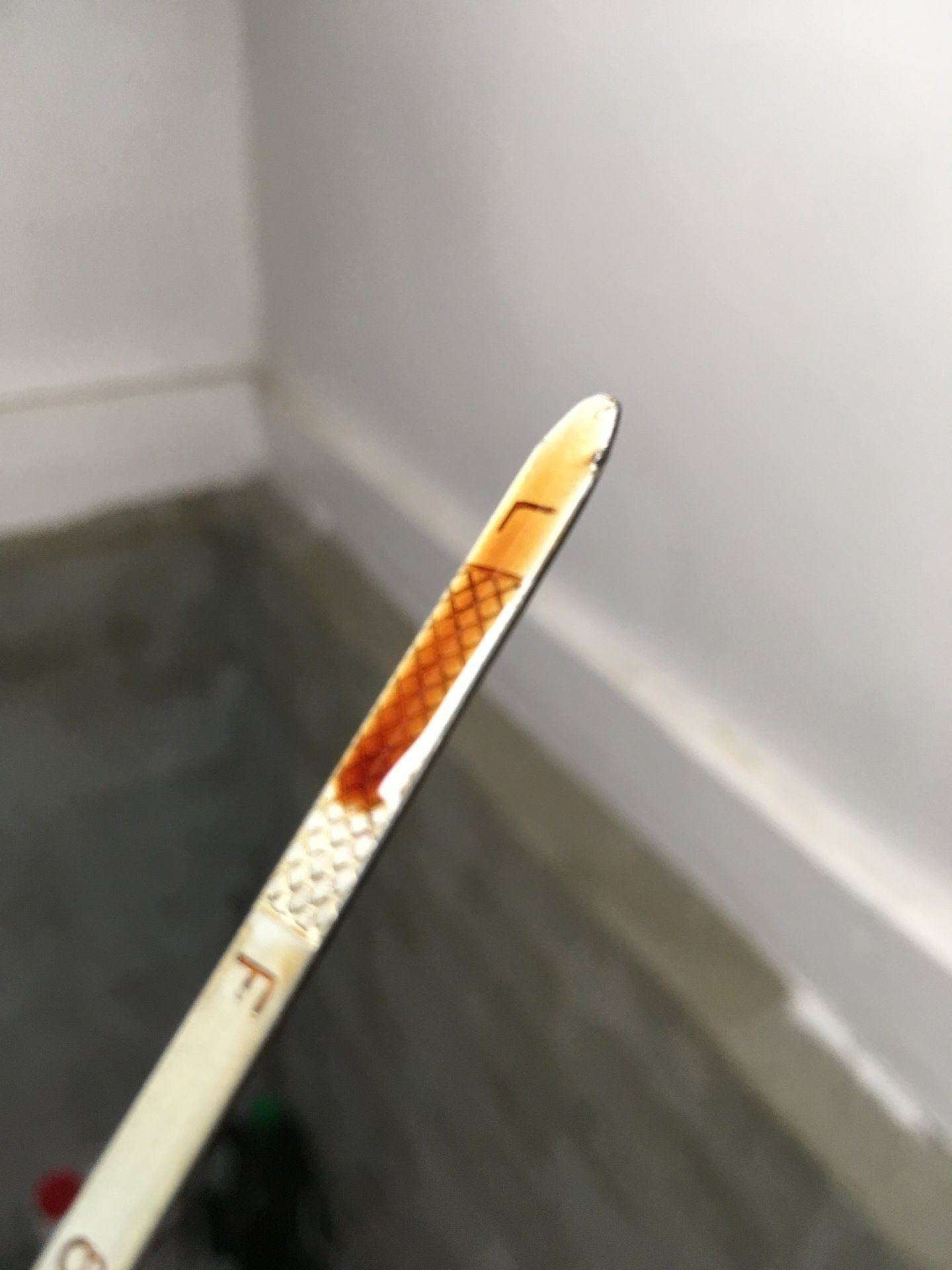

Have you checked the condition of your engine oil? The PVC valve looks contaminated by moisture.
The first item on my hit list for hesitation is the PCV. It is cheap, easy and right on top of the engine. That one in your picture looks like it has a disease...check your oil.
Just checked the dipstick quick. It looks good to me, but I can’t say I know what I’m talking about. I did just check the coolant overflow tank... completely empty. I made sure it was full before the trip (it was empty). I did just do a complete coolant flush two weeks ago, so maybe I didn’t get the system completely full and it’s equalizing? Is this wishful thinking?
I have checked the oil and the coolant and there are no signs of cross contamination. I did find that one of the new OEM coolant hoses that I installed before the trip did not have the hose clamp attached at the end of the hose but rather in the middle of the hose, and the hose is hanging low on where it attaches to the engine. So it seems I forgot to secure that hose clamp and that is a possibility where the overflow coolant has leaked out. Whew that would've been nasty if that hose fell off during the trip.
