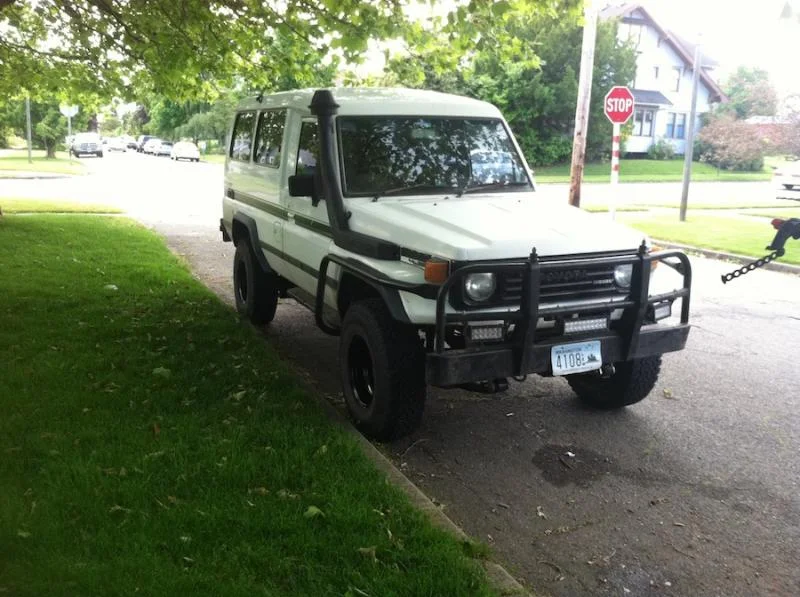

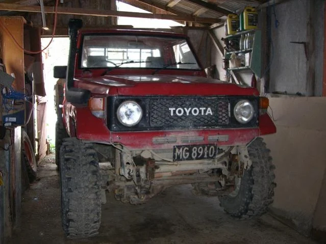

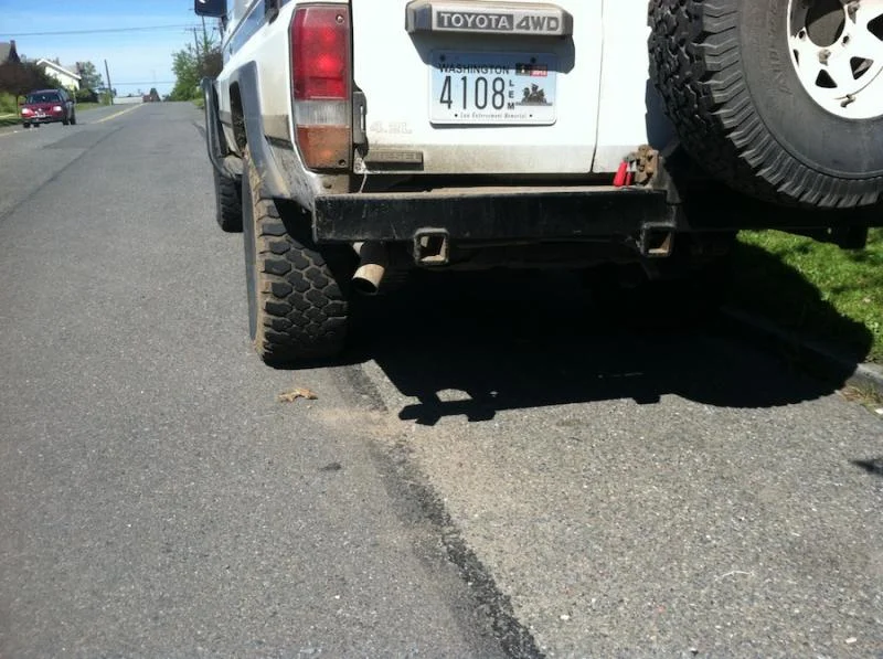

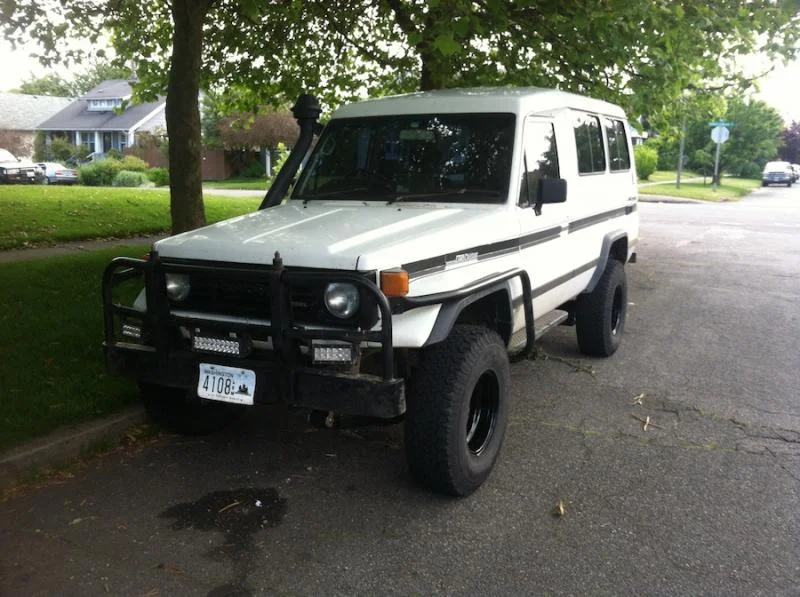

Ok I got three pics for you all with different rim/spacer/tire combinations.
1st pic: 16x8 rims w/ 2.75" backspacing 1" spacer and 33x10.5" Firestone? (winter)
2nd pic: 15x8 rims w/ 2.5" backspacing 1" spacer and 35x12.5" Mickey T's MTZ
3rd pic: 15x8 rims w/ 3.5" backspacing 1" spacer and 33x12.5" General Grabber
So the first two pics are of my daily driver BJ74 (OME 2.5" lift, extended shackles) with my summer and winter set ups. I've been running this way for a few years now (about 60,000km) and never had a problem yet.....and yes I do wheel it. I definitely like the added width on and off road and would like to go even wider but tha'ts going to take some work (widening axles and fender flares). The 3rd pic is of my BJ71 (stock leafs w/ extended shackles) that I sold
The only downsides to the width is obviously the tires are going to throw a lot more dirt and water onto the body and the tires are going to get into the sheet metal on your fenders on full flex instead of tucking inside. I've had the 35's at full flex rubbing too many times to count but its never been hard enough to do any damage. I now have a U-bolt flip kit installed up front and as a side effect its effectively increased the bump stop by 1" and stopped any rubbing.
Thank your very much for posting those pictures! I actually thought that the 2.5 would stick out a lot more than that and you even have additional 1" spacers in there. 2.5s do not seem extreme at all..someone had told me tires would stick out over 4 inches.
