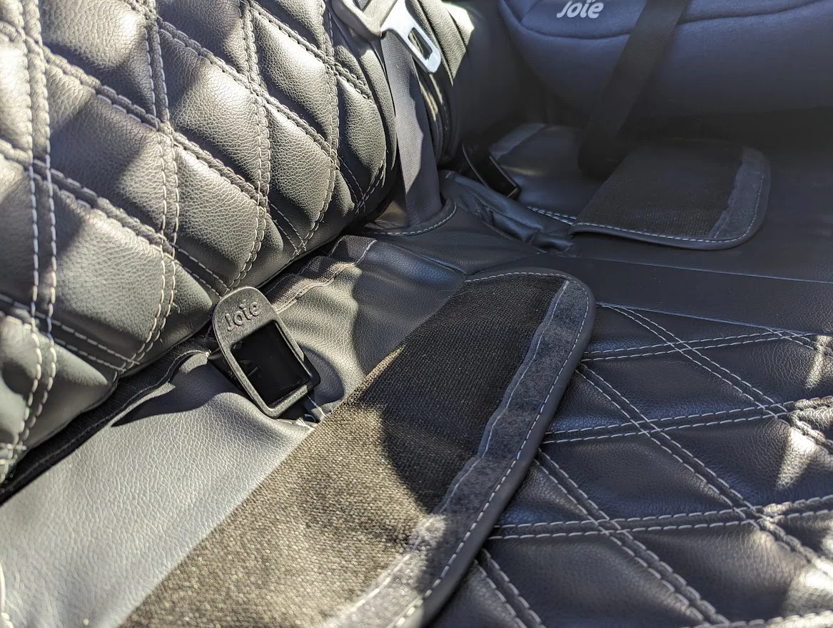

Yes, your truck is old but from what I can tell almost all, if not all of these 120's have four (4) ISOFIX latches on the second row.

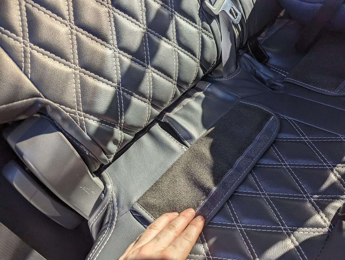

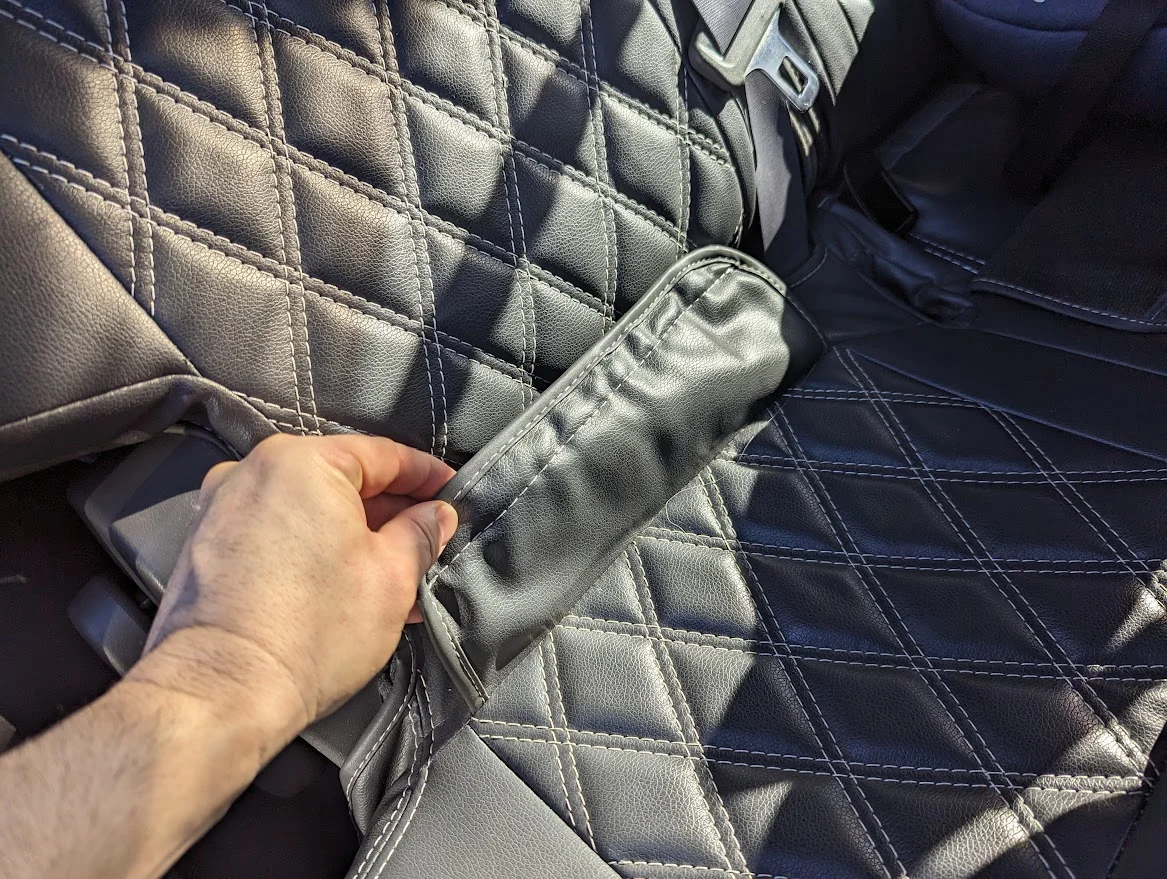

I have seat covers on mine but even they have the same velcro'd flap you need to pull forward to expose what you're looking for....

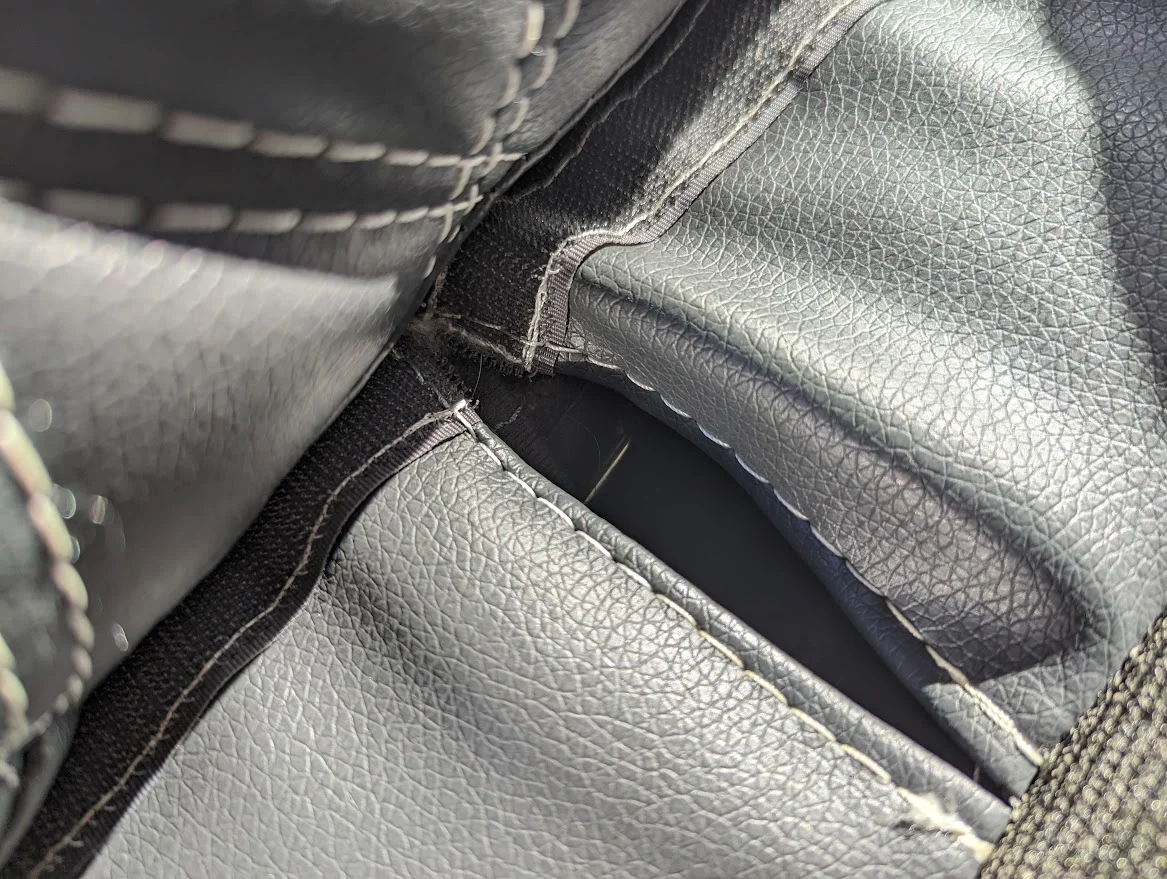

Yes, that.....gash is what you're looking for.
That chrome piece in there is the ISOFIX G-spot....keep it PG keep it PG

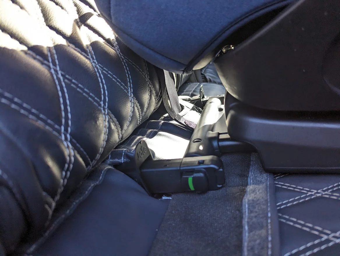

If your baby/child seat is like mine, you might have some plastic guides for...easy access
Penetration achieved!!
Mission accomplished....and now you're reminded why you need this thing in the first place....
