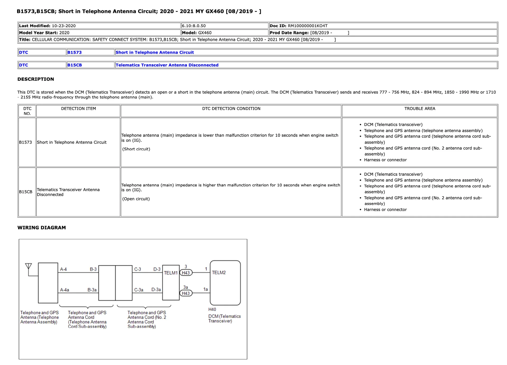

While doing routine maintenance, oil change, tire and fluid checks, I scanned my vehicle for any other problems. No CEL, just wanted to check, and a B15CB Code came up.
Telematics Transceiver Antenna (disconnected)
Is this normal? No one has mentioned it in the GX forum here, so, I thought I’d send it up.
Thanks in advance!
IMO: I'm not sure I'd worry about troubleshooting this unless other failures show up. As of 10.31.2022 that 3G Enform system for 2010-2018 models went offline permanently. The antenna for that service is providing nothing to your vehicle at this point. The GPS antenna is in the dash near the nav unit.
Is your Navigation system tracking accurately?
Have you been in the center dash at any point and worked on any wiring or connectors?
everything is working as advertised, i was curious what the code meant. I appreciate the input!
