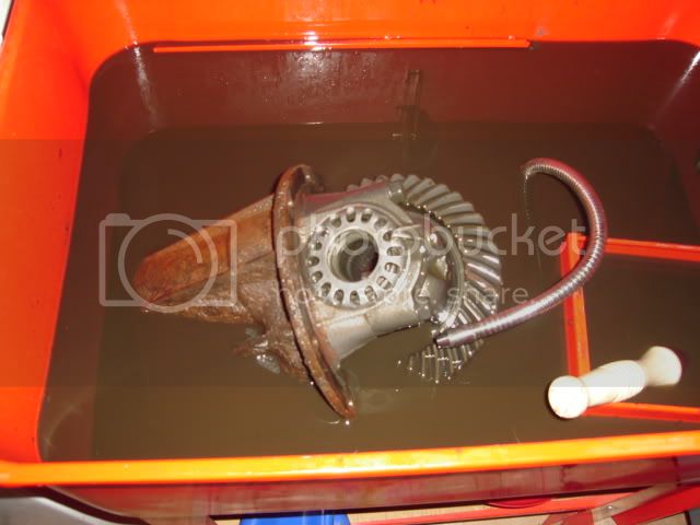

I broke down and bought a cheap parts washer and solvent. It's been worth every penny too! Specially when cleaning off Birf-Soup!!! ;)

I love my parts washer. I just brush off the big chunks and drop the parts in. If it's not clean after a day I just leave it in a little longer... Beats using your wife's tooth brush!
