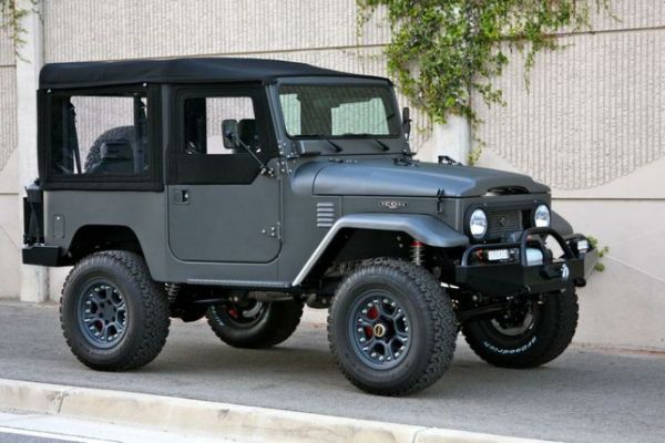

I just really want the rig to look similar to this, just stretched 10" inches and be able to cruise me and my family around on camping vacations. Thanks guys- Don
