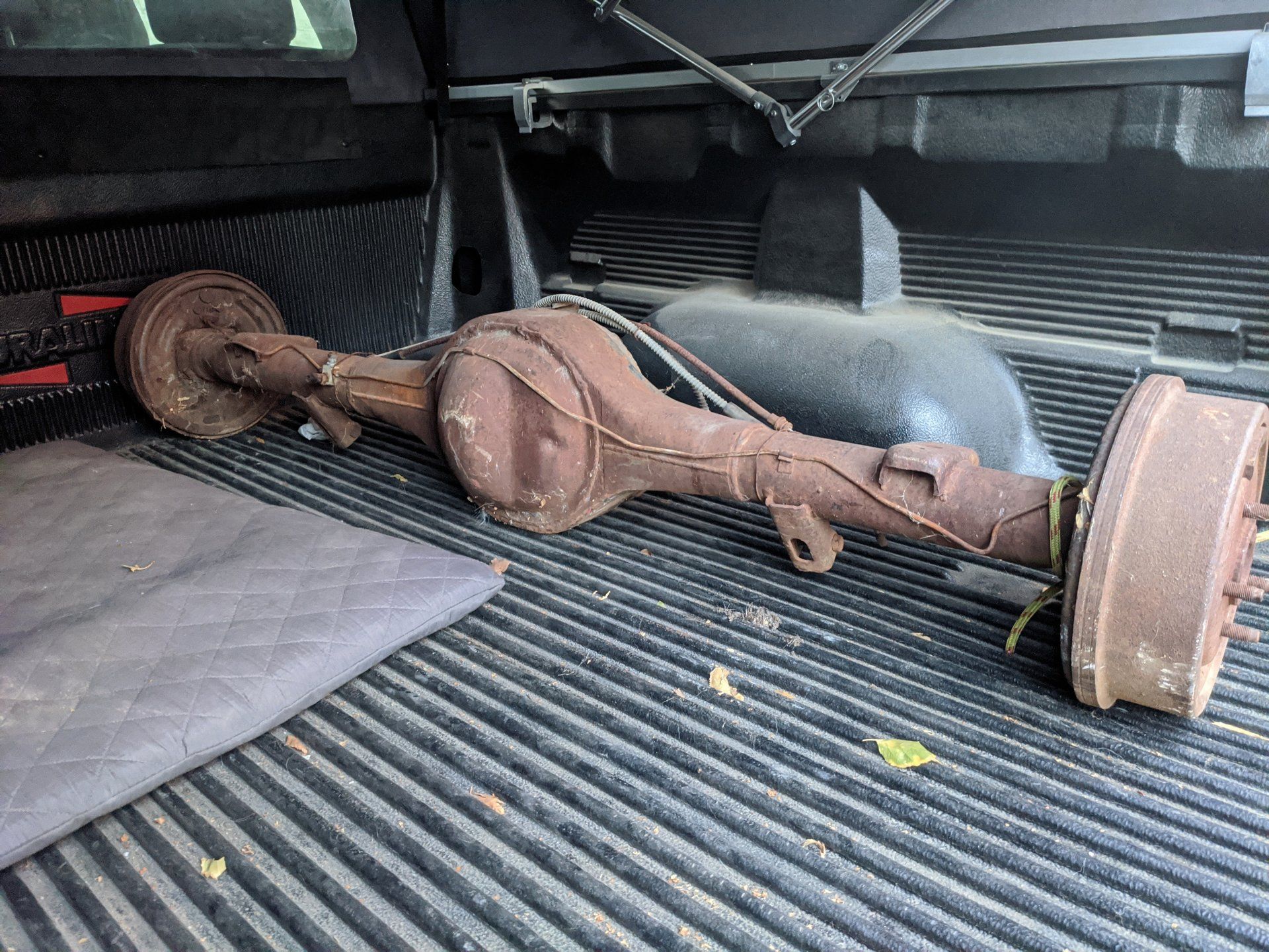

Couldn't resist a good deal, so hello Ford 9!
I don't even know if I can make it work yet. Obvious upgrades are disc brakes, 35 spline axles, lower gears, locker, etc. Still figuring out how to make the GX bolt pattern work without too many custom parts. Hopefully Currie still sells their 120 series link brackets.
Worst case scenario I clean it up and re-sell it, best case scenario I don't get booted from Mud for shopping outside the Toyota family :p
