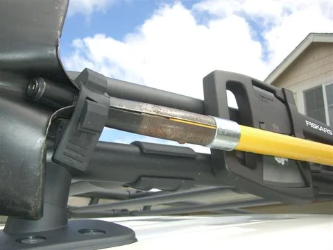

I used a Fiskars axe with the head mount it came with, and three Quick Fist Clamps mounted to the rack with hose clamps. I covered the hose clamps with electrical tape so they match the black rack. So far it's been working great. I used both of them last week in the snow.:)

BigBlue, thank for the picts. I think that might be the way to go, quick access and secure mounting, gotta love it.

I just got my quick fists today so dad went down to the hardware store. Got a 3ft fiberglass shovel with the grip handle (like BigBlue's but red with a hammer battleship grey blade) and my dad, always thinking, got U bolts and plates instead of pipe clamps. I put up the shovel just now and it doesn't move, period. The u-bolts work GREAT! I'll get some picts of how it works out when my axe gets here on Monday and I put it up. My CB also came in so I gotta get it put in as well. And the best news is my Gobi ladder will be here next week!
I think I tend to prefer the quick grips over anything else because it's a rubber mounting surface which means 1) it won't harm the stock rack and 2) it won't transmit vibrations or rattles.
