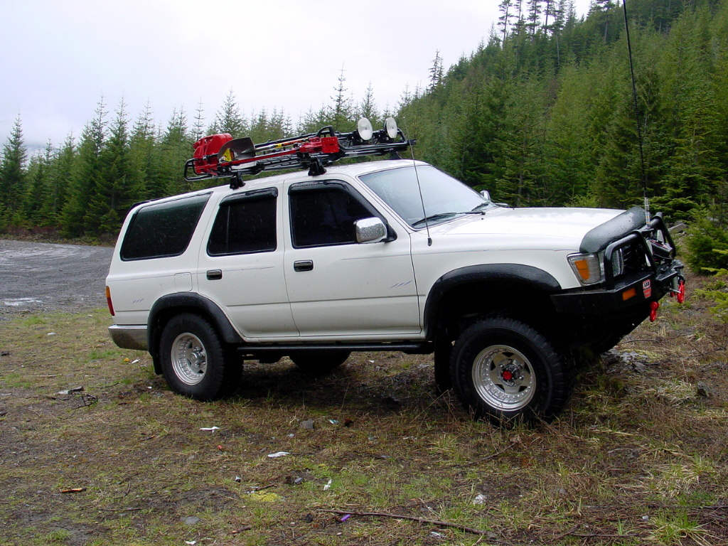

It is already setup with the Slee Hi-Lift mounts, Yakima axe mount, a home made shovel mount, and a home made jerry can setup.
http://www.pnw4runners.com/runs/41203/5.jpg
http://www.pnw4runners.com/runs/41203/7.jpg
Axe mount
http://www.pnw4runners.com/runs/41203/8.jpg
