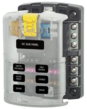

Got it.
Blue Sea Systems...

Thanks @jgranthevagrant - I'll look at that one too. I'm thinking the amp and maybe a small compressor will be the big draws. The winch will go to the battery.
