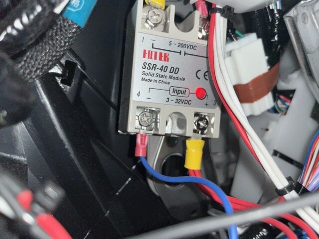

The blue wire on terminal 4 goes to ground somewhere. Otherwise the relay would never work. Most instrument lighting in Toyotas is ground switched through the BCM. So the installer was attempting to piggy back into a circuit that is being switched by the BCM with the wire from terminal 4.
The first test I would do is measuring voltage at terminals 3 and 4 with truck on and off.
Set your multimeter to measure DC voltage. (Set range to cover 0-15v, use whatever setting will cover that). Put the black lead on term 4 and the red lead on term 3 and record V. Do this with ignition on and off.

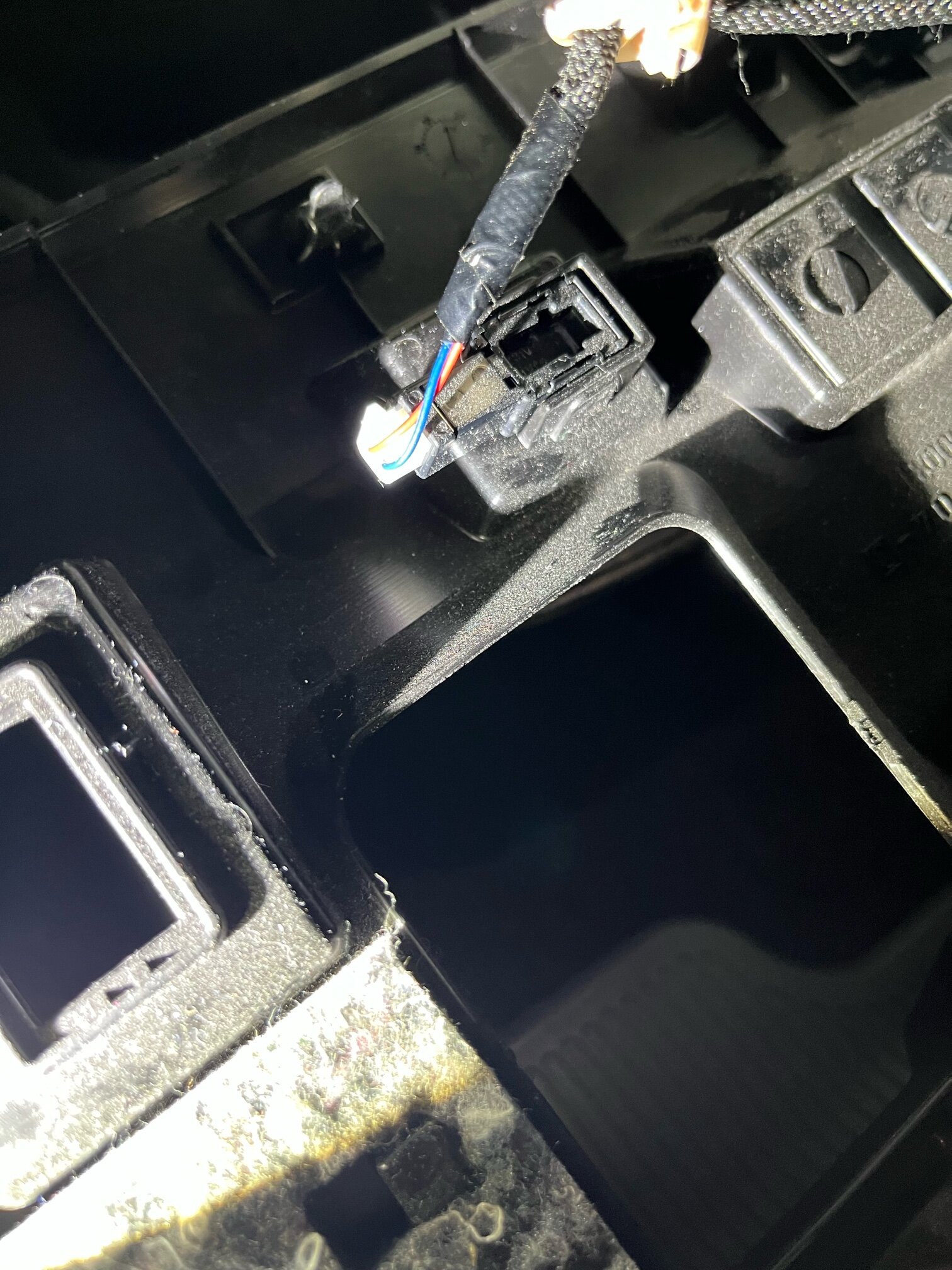

term 4 is connected to the BCM under the dash by the brake pedal---presumably tapped into the dome light. See pic---that's where the blue wire runs.View attachment 3834148
The Blue wire in this photo is the negative lead from footwell courtesy light and leads back to terminal FSPT of the Body Control Unit which should be switching the circuit to ground with one of the 4 door switches opened.
The Red/Yellow wire is the LED positive power feed from the 10A Dome Fuse with direct Battery 12V supply.
Check your voltage between Relay Term 4 (your Blue wire) and a chassis ground. Voltage should be Zero with doors closed regardless of Ign on/off

I’ve got the dash apart with the relay accessible. I see the white and black wires coming in from the lights (each side) .
Looks like 2 blacks from lights (1 from each side) go to ground.
RELAY:
Terminal 1 top left: Two whites from lights (load) and a third from switchbank goes into top left slot 1 on the relay.
Two wires are Load wires to lights, 3rd wire is a power source bypass through the switch, bypassing the relay
Terminal 2 top right is a single red going out to I don’t know where (maybe dome)
This is your 12V power source for your ditch lights. rather than being feed direct from battery they just piggybacked form power source for the trigger circuit. Nothing wrong with this at the low averages involved.
Terminal 3 lower right is single blue (maybe from dome? Or the open door circuit signal)
per Photo this is the terminal with a number of red power leads, its correct that these should be 12V power supply.. one lead is carrying power to Term 2 and other is caring power to switch fro bypass.
Terminal 4 lower left is 3 red wires and I assume those are coming in from the power source but one is coming in from the switch in the switch bank..
Blue wire should be a triggered ground. Triggered by the doors opening. As show it should be connected to the blue negative wire of a courtesy light that feeds to the BCU and is switched to ground when a door is opened.
