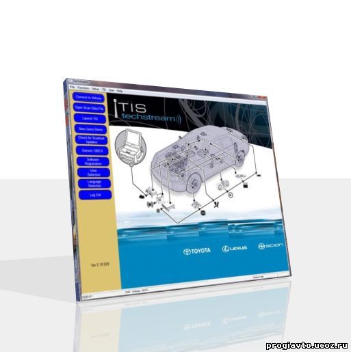

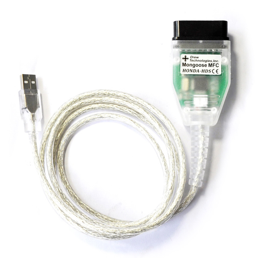

I am using a Mongoose Cable with Toyota Techstream

The cable and software mentioned in the previous post will work on any old laptop. Will set you back 35 $ if you choose the cheaper option.
