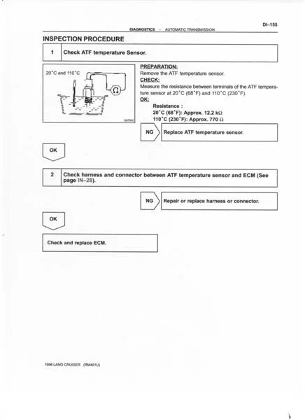

The AT temperature sensor in an 80 does more then the temp light. The AT will not go into OD until the trans reaches operating temperature and the sensor lets the ECU know this. So the sensor has a variable output so the info is there for the taken.

I have driven vehicles in the past that required the engine coolant to be warmer than a set temperature before the torque converter would lock up. The thermostat was broken for a few days, and it wouldn't lock up until the thermostat was replaced, thereby allowing the coolant to reach the normal operating range. Are you certain that the ATF fluid temp is what the 80 ECU is using, vice the coolant temperature?
Certain…I’m old :flipoff2:and going off memory:eek: of the research I did a couple of years ago on my 96 SC 80. I was going to go to a remote stand alone trans cooler and bypass all the Toyota stuff.
I did check my 80 file and found this doc out of the FSM that shows the trans sensor to be variable. So what I am certain of is that the info is there for the taken.
