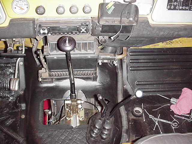

This is what I have in mind so far.
How easy are those to get to Neutral? My concern is that with running an auto, 4.0 front case, 2.28 split case, and 4.56 I'm going to need to use and be able to get to neutral quickly as I'll probably be driving through my brakes in stupid low...

2nd - Any of the ratchet type shifters suck major donkey ass off road. A gated shifter like the Art Carr is the way to go.
I put a Lokar into my truck, i wish i would have gone with the art Carr.. and don't even bother with the ratchet style ones.. ive heard horrible things..

Well, decided to go with the Art Carr as long as I can get one fairly quickly. If not I kinda dig the quicksilver as its the least rat-sh*tty of the bunch. Thanks everyone.
