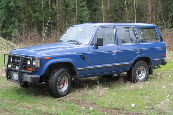

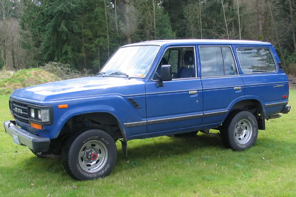

Figured I may as well just make a post so others can see the difference as well.
Before:
After:
Shackles are still stock length, as are the shocks. Only thing to make a difference in height is the AALs. I'm stitting I figure about 1" higher than factory new, and my springs were sagged about 2", so I gained about 3" (give or take) height overall. the AALs combined with poly bushings make for a pretty siff ride, but it's not uncomfortable.
And the el cheapo brush guard is long gone :D
FJsixty2 said:
wow, that looks like some gain from AALs. did you go with the short AALs?
Nope, went with the full length after a few guys said the shorts made for a WAY uncomfortable ride. I took the after pic just a couple days ago, and did the install back in December, so that's allowing for a few months' worth of settlage.

Fawkin Sweet Dude!
Im definately going with AAL. That Looks like at least 3 inches.
