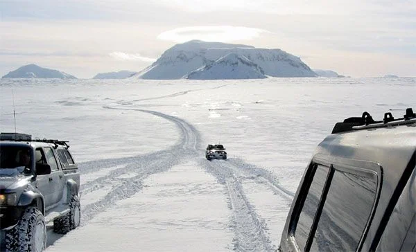

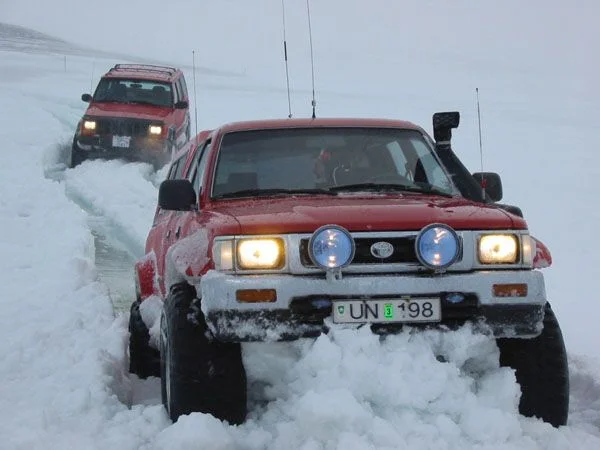

Many in Iceland are taking their LCs (and other 4x4s) up on the snow fields/glaciers (not so wise IMO, being a climber myself) on trucks with HUGE tires and very low pressure. These trucks, even at their significant "heft" literally floats on top of white stuff - until they make a mistake and get stuck...
On of my Swedish friends live in Icelend and points to this site for some serious 4x4 travel on snow and ice: Fjallavinafélagið Kári
OK, so it's all in Icelandic, but if you click on a small link to the left you can get to some parts in English. There's a link to "pictures" and a bit down on that page you'll find a lot of 4x4 pictures in the white.
A few samples:

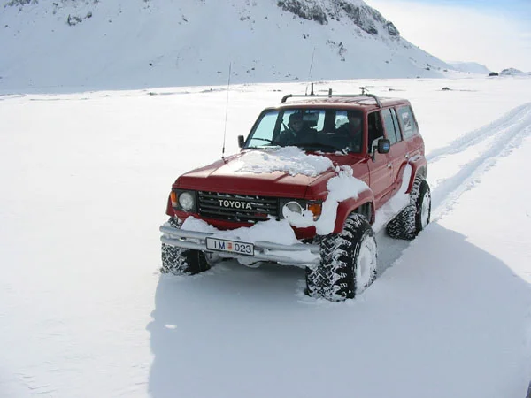

That red truck may be the sweetest 60 Series I've ever seen... :cheers:
Derek,
Sad to say it, but the red LC 60 reminds me too much of a Nissan Patrol, early 80ies model)....;)
