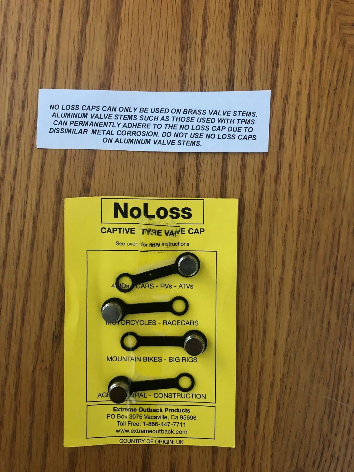

Let's say your boy goes to work for an ARB vendor, and let's say his first check he wants to get something from the shop, and let's say that something is ARB valve stem caps. Then let's say we fast forward a few months (about enough time for a dissimilar metals reaction to take place), you will NOT be airing down on the trail. At least without two pairs of pliers to get, of all things, your valve caps off.

Along with those thoughts, I had ordered some parts from LCP - I can't remember what it was, but Phil threw some "No Loss" valve caps in the order. They seemed like a good idea until I read the warning that came with them:
Thanks for posting your experience! Just a little more info on the subject.
