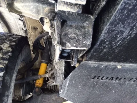

The Joneseys recovery points will likely require a little grinding of the bottom of the shoe that mounts over the frame horn. Not the end of the world. More modification may be required with skid plates. I have the 03+ ARB combo bar, maybe the Sahara is different. The recovery brackets are a quality piece of gear for sure and the folks at Joneseys were very helpful.
I have the ARB combo and mine bolted up without issue. Remove the weak OEM ones, bolt up the heavy duty ones.

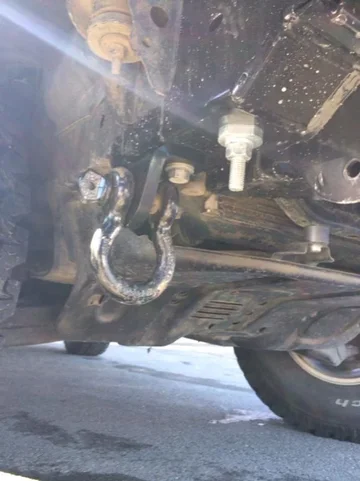

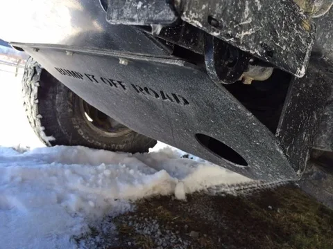

Mine bolted right in and the installation was very simple. However I had issue once I went to install a shackle. The ARB "shoe" is notched to allow this to work but in my case either not notched enough or the recovery point was a touch short. As noticed in the pictures I also have an issue with the skid plate. It'll be a great product once I get it to function.

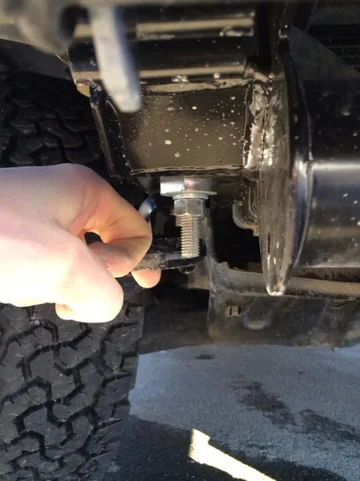

Got the tow points mounted up no problem with the arb Sahara:
Not a fan of how long the arb support attachment bolt is. Could see this rubbing up against a strap so will probably cut it off sometime. Sometime when it's above freezing and I'm not laying outside on my back!
