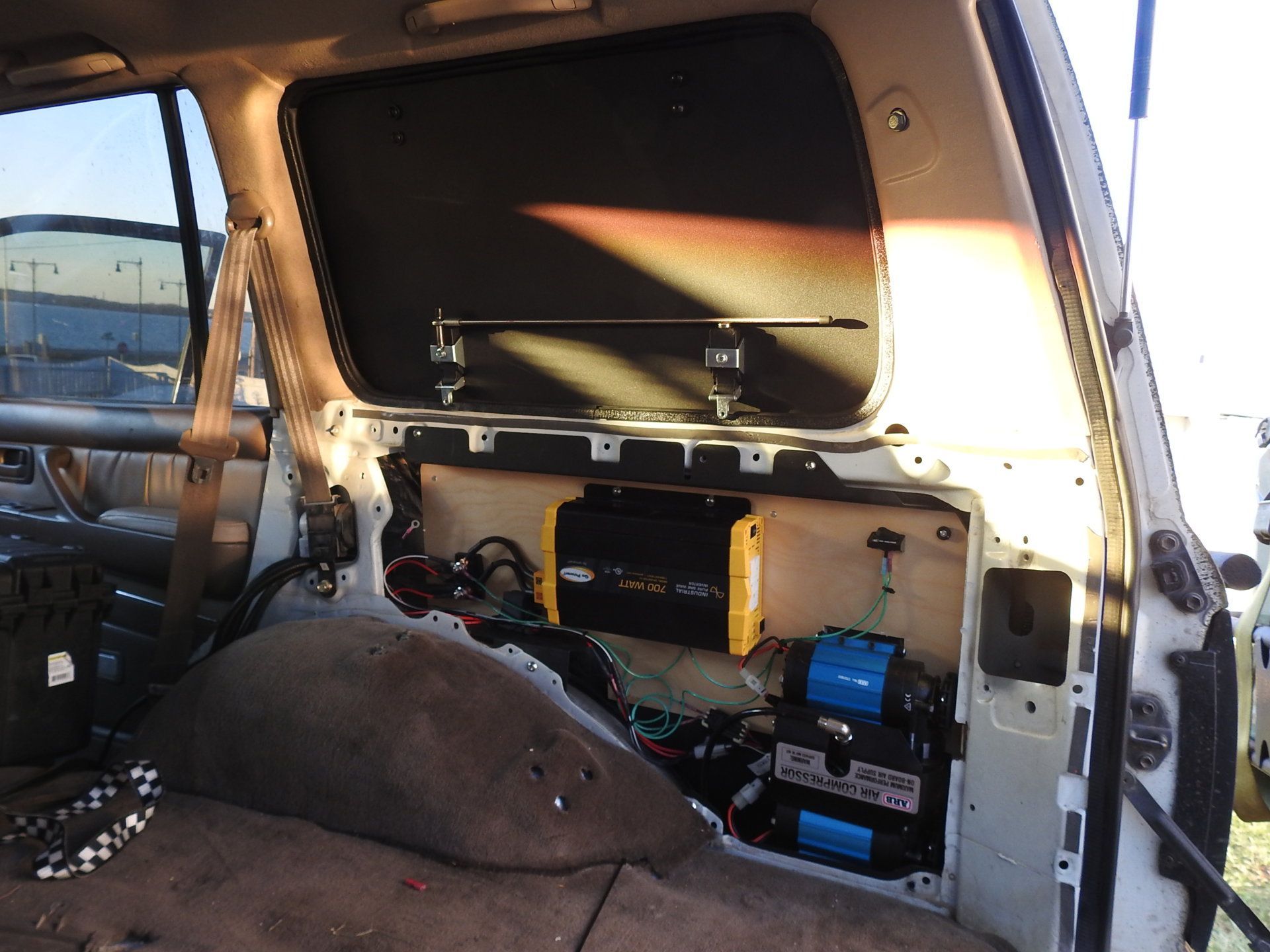

I hooked up an ARB twin with a 2.5 tank under the truck its all wired up running but Im wondering does it need to manifld from ARB to regulate the output or will it be fine on its own? Meaning I see it has a pressure switch already on it, will that work. what did you guys do??

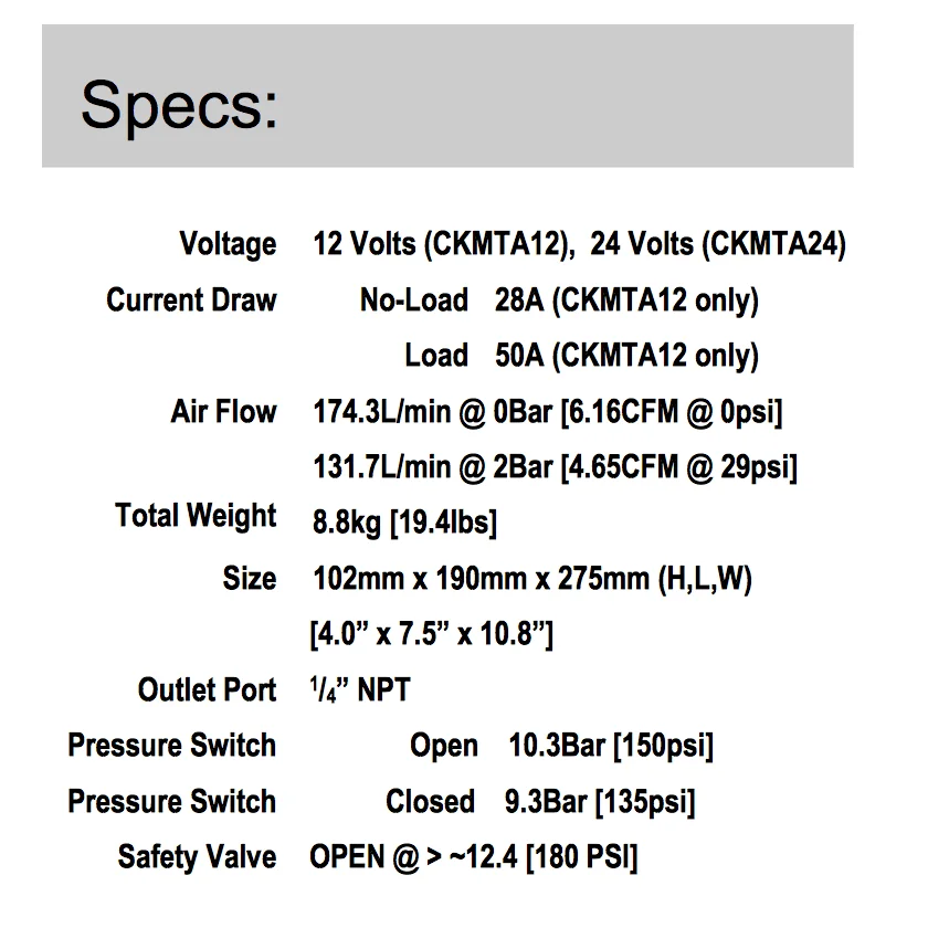

IIRC the integral high pressure switch for that compressor cuts off at 155psi. So unless you need lower pressure (like for an ARB air locker, air tools, etc.) and all your lines, tank & fittings are rated for that (or higher) you are good to go.
thats what I thought but couldnt verify it on any ARB site or literature, thanks
Just verified: High pressure side of cut-off switch: 150psi / low side "on" switch: 135psi.
