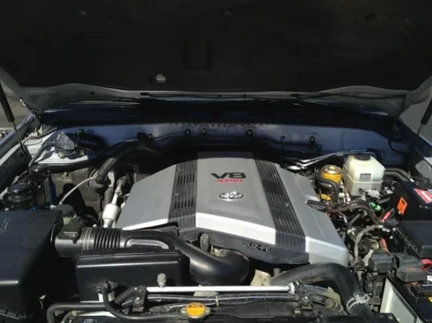

All you can see is the loom looping up into the air, but it's between the air cleaner and the 2nd battery.
attachment.php
There's definitely room there, although it's a little tight. Maintaining room for the 2nd battery is probably your most limiting factor.
Here's mine on front pass side. It fits just fine but as mentioned the second battery would be a squeeze.
