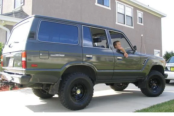

Props to 3PUTTCOP for this photo....this is what I am looking to achieve.
attachment.php

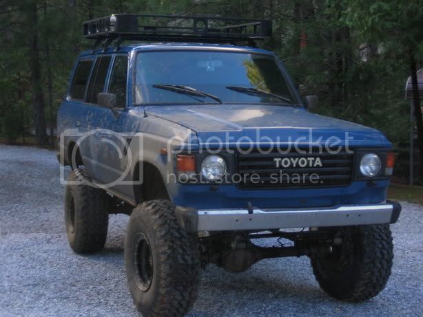

my case is a little different since i went SOA but i went a 15x9 with 2/75 BS on 35x12.5/15 and its nice. Like i said its different for me since i went SOA becasue i have plenty of clearance, but definetly widened the stance.
