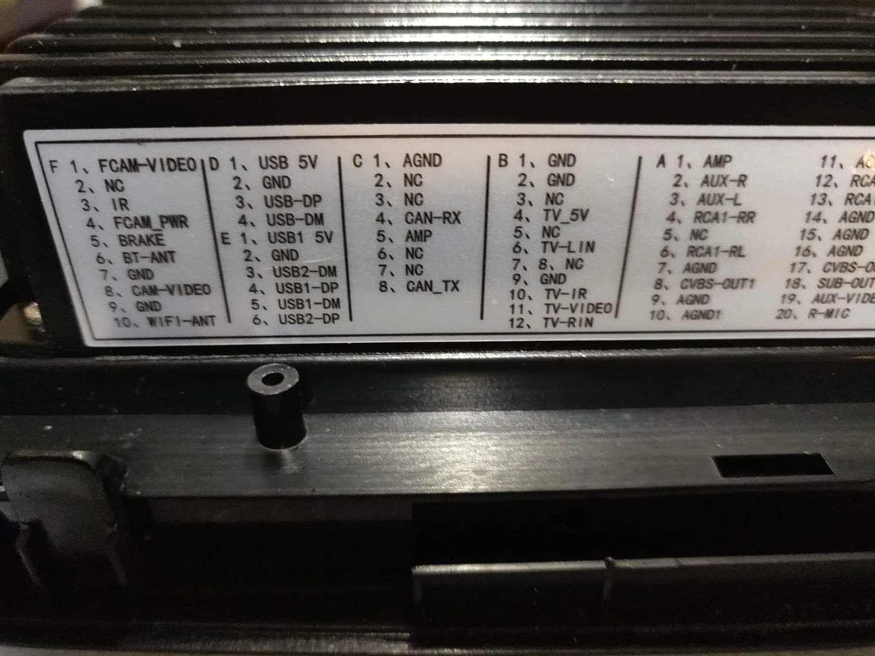

I also got the wondefoo unit. Did you ever get your front camera working? I'm curious to know how everything is wired up.
Front camera is working after I add the missing power cable from the harness. You need to power the camera from the head unit. I believe it was Connector F pin #4. Mine was missing the wire and have to add it to make it to work.
Once wired you could see the image thru FCam app. You can also set automatic timer for for long you want the front camera to come on from car setting menu.
