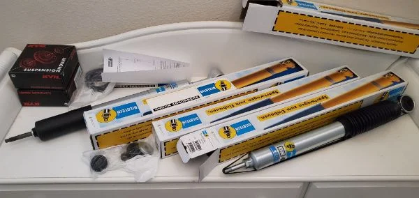

I got all of the parts on hand now:
My plan is to start tomorrow Friday. I have found one video on doing this on a gen4 4Runner, so I have a place to start. Any other things I should know before I do the swap?

Of course got the new KYB tops ready as well:

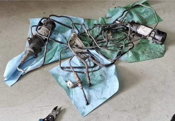

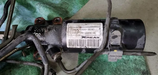

All done. Man, the x-reas system was messy:

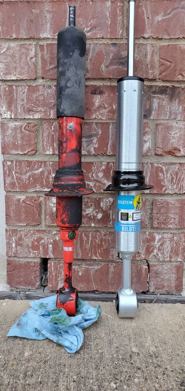

All shocks were leaking, but more so the front ones (here next to the new one):

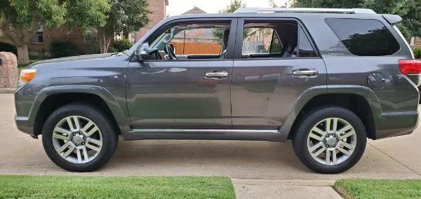

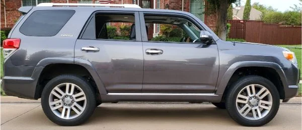

Used the first level up, for about 3/4" or so of "lift" on front, which now makes it "closer" to being/looking even with the back:
