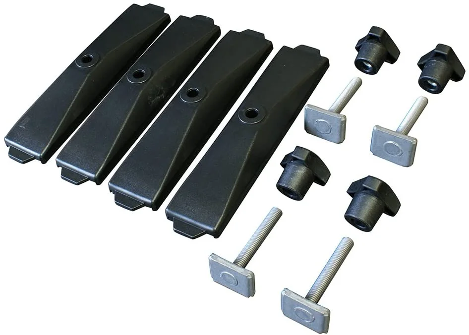

I’m going to look at the Thule T-slot adapter, and ARB t-slot blocks as I’ve read elsewhere. Maybe make some rubber mats to fit under the clamps.
Because what’s another $100+ to make something work? 🙄

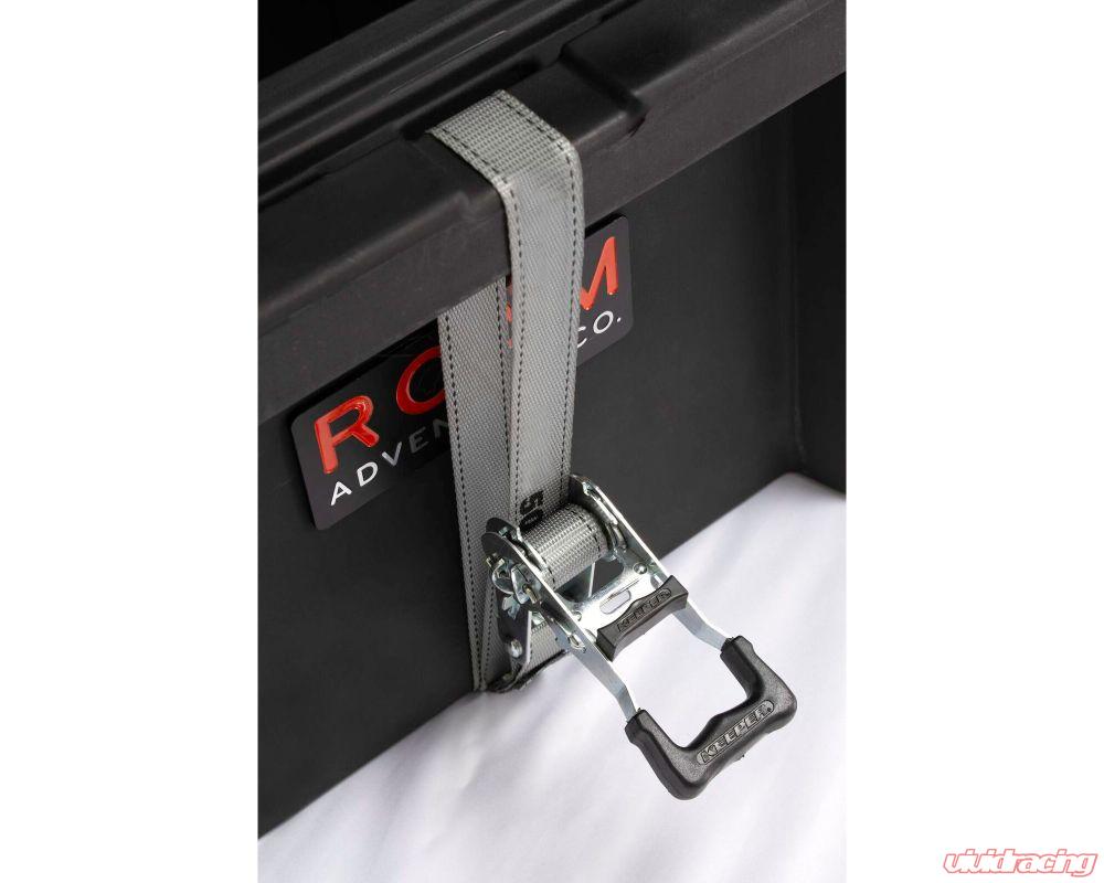

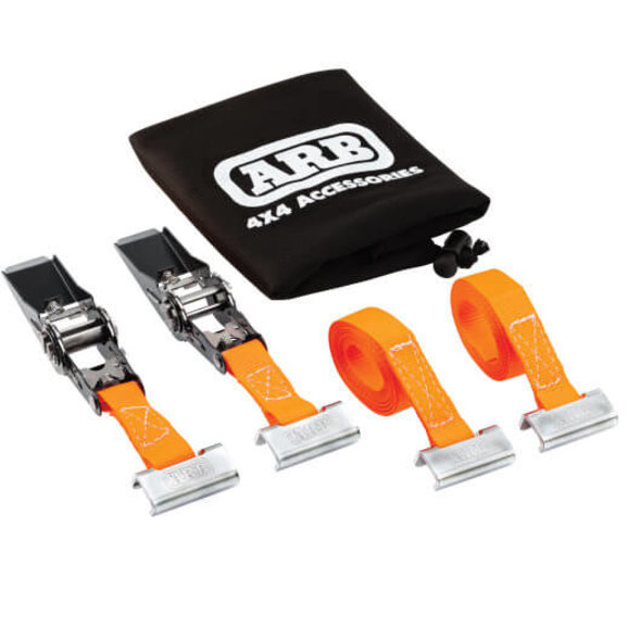

I was thinking about using a roam 95L case. The cargo box has slots at each end through which you can loop ratchet tie down straps sold by ARB. You can still open the case without removing the straps. By my estimates, the length of this case is slightly shorter than the dovetail edges you would use to secure the straps.
Interesting solution but I already own the Thule box, it's more secure and its access is more convenient as well. This box would be great for camping, etc.

Posting this for anyone else searching. Front Runner has a quick release bar, but would require ARB T-Slot adapter:

Just a update from me I have successfully achieved putting my thule xt motion xxl on my arb bas rack with the below
Thule Caprock cargo box kit​
T-Slot Adaptor (Single Or Pair)​
I am searching for this solution for the last 2weeks. I have a Thule Force XT XL from previous setup and now with an ARB base rack. Where did you ordered the cargo box kit from?
You can get that from Rack Attack, hell even Amazon. I don't like how it puts the box back up in the air though.
I'm going to do the T-Slot and have tap plastics make me some spacers for the box gap. I want the box in contact with the rack full length, not just at four mounting points.
