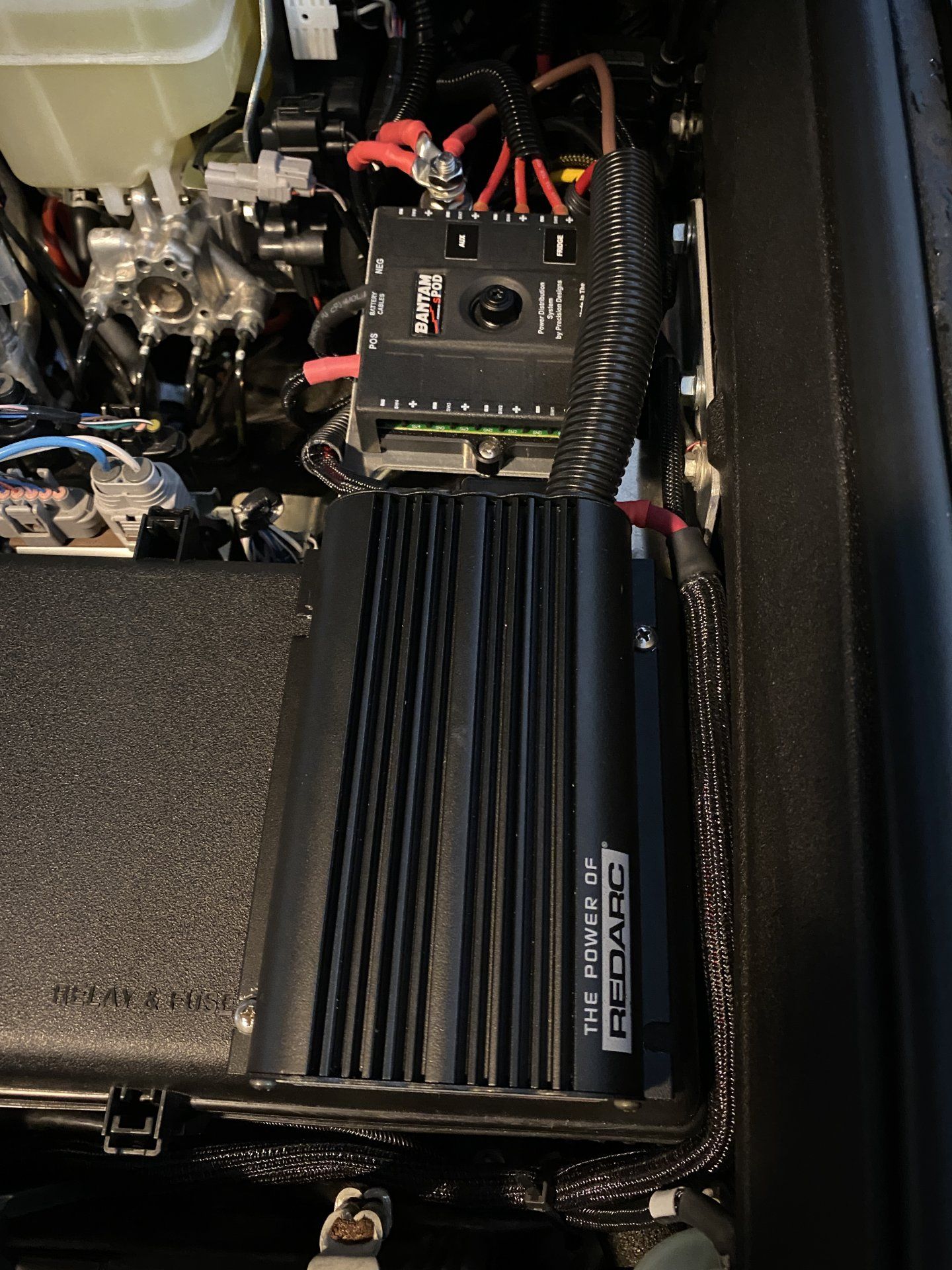

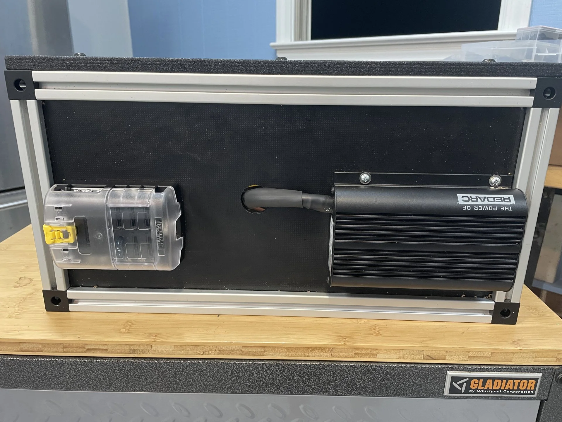

I am installing a BCDC1240D in the rear of my truck to charge a Renogy 100ah Lipo4..
The idea was shorter recharge time and greater float time after it tops off. It will mainly power the Nation Luna, and some plugs in the rear, I am not planning on an Inverter right now.
The stock battery is just a normal wet cell G27.
I will be running 4ga cable from the stock battery, with 60amp circuit breakers at each end (Anderson plugs in the rear for a manual disconnect as well).
The location will be cooled via the vent on the side of the cargo space and is mounted to a Goose gear box (part of the ultimate Chef system).
The rear seat fully reclines.
