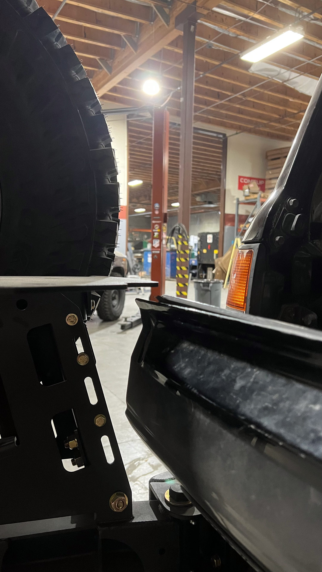

I’m interested thank you. Ready to ditch my cross member anyway. Question I watched a review that the fold out table doesn’t clear the tailgate and hatch. Table out; can’t open hatch. Tailgate down hatch open; can’t open table. Has that been addressed? Also can you order just bumper then add swing outs or is it an all at once deal? And do you have any incentives for the mud folks
That video was an install error, the video has since been revised.
We're a land cruiser company... making sure the table clears the tailgate is a mandatory for us :)

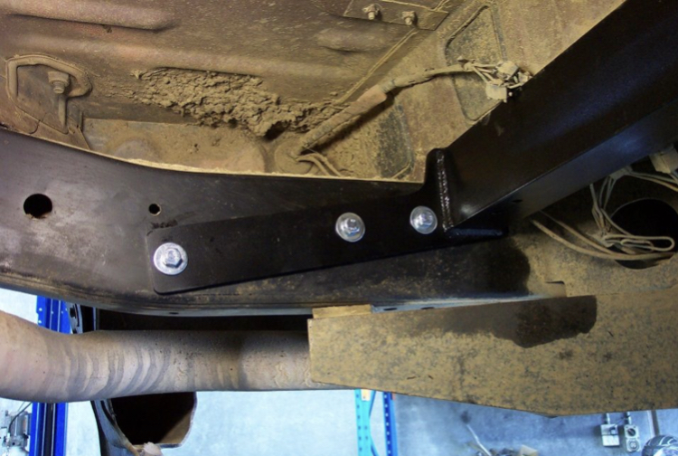

@MoJ do you have a good picture of the tank install?
The rear bumper has two braces that go from each side of the receiver to the first(from the back forward) row of bolts for the bracket that once held the tire winch. That is all there is between the rails as everything else attaches to the outside or bottom of the rails and does not protrude inward.
I purchased a 24 gallon tank but it’s been delayed for months otherwise I’d take some pics. I stole the below pics from Exit Off-road. They’re of the 42 gallon version which I believe mounts the same but just hangs way lower. Same length and width dimensions I assume.
Comparing to the last photo you posted. Ignore the bird's-nest. I think that bracket is likely using the same holes as the brace you have installed.
It appears so. Thanks. Wondering if they can both mount to the same holes.
The original anti bird nest plastic cover is still available 😁
Ha i know. I have since removed the nest. I park in a garage so that is a 5 y/o plus nest. I am going to order a replacement cover.
so is it possible to have a lra aux fuel tank and have the dissent reat bumper?
Yes, you can run the LRA with the Dissent rear but you will sacrifice tow strength. The additional triangulated braces we supply are not required for installation if you are not towing any heavy loads, and as surmised before they do need to come out to fit the LRA tanks. Our supplied crossmember clears the tank no problem.

I am having this issue too, what was done to fix this?
Got a picture of your install with the table opened up?
Likely you have a large bumpstop on the outside of the arm, or too many washers "building up" the bump stop. Swap the thinnest bump stop you have to the outside of the tire carrier arm
Thank you - makes complete sense!
