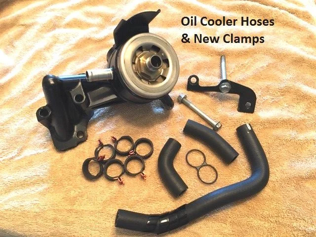

One tip I can give you is when it comes time to put the new ones on buy new clamps from Toyota. They come with a little tab that holds them open so you can easily slide them into place and then just pull the tab off and they snap shut. A lot easier than trying to compress them with pliers and slide them into position. Good luck.

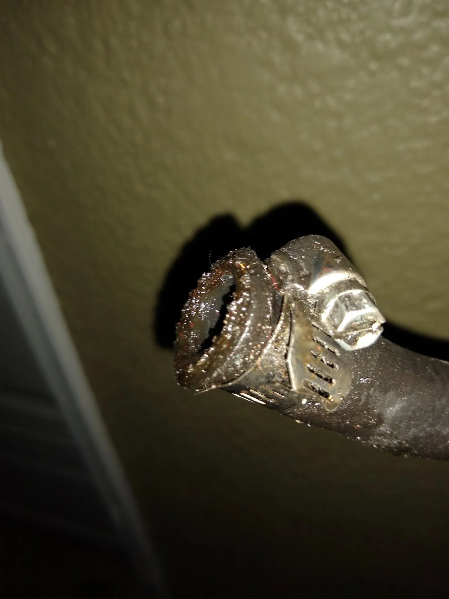

Ended up snaking my hands above the CV shaft to get an angle on it. I would not recommend doing this as PM unless your hose looks like mine.
In hindsight it might be better to just bite the bullet and slide the AC compressor forward, would probably save time in the end.
Non oem clamp....🤔

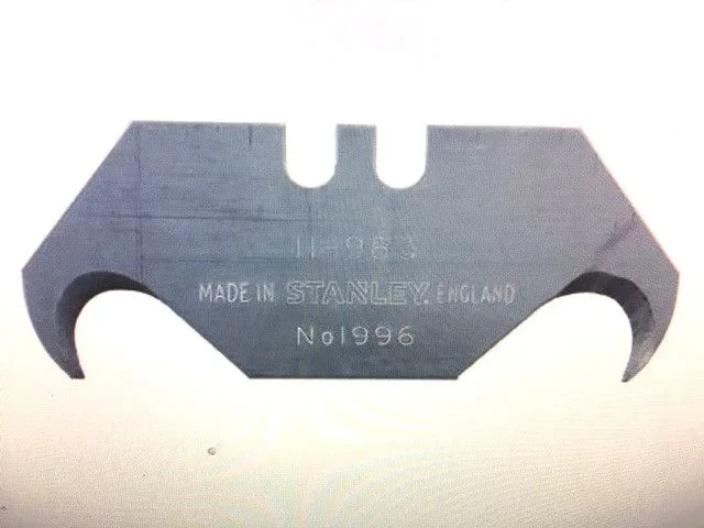

Hooked blade for a razor knife makes slitting the hose a breeze and allows good control in tight quarters.

always order new clamps so you get the red keeper clip. Those are absolute gold. Keep them so you can reuse them on other clamps. Bench vice and vice grips not included.
New Toyota hose clips and cable type hose clamp pliers. However, if you have to replace your AC compressor - DO THAT HOSE. It's easy and right there in front of you with the compressor out.
