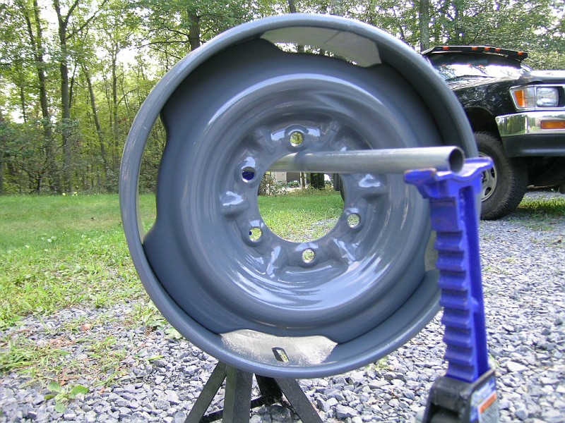

I just used Valspar's Tractor and Implement paint on my new stock rims and it was great. Went on thick and smooth and dried pretty quickly. It is resistant to gas and oil and is pretty heavy duty. I had my local do-it-best hardware store order it for me.....here's a link: I.h. Red Spray Paint by Valspar Corp - More Spray Paint at doitbest.com
And here's a pic of the finished product:
I am a bigtime new fan of Valspar rattle can as well. Although I wish I knew of the tractor line beforehand. I used the medium gray I got from Lowes and am extremely pleased with the finish. Hopefully it's as tough as it looks.

Joe_E, is the Valspar hard or will it indent with your fingernail say a couple of weeks after painting the wheels? Where did you buy it?
Lowes carries the Valspar premium line.
No, my paint dried hard.
