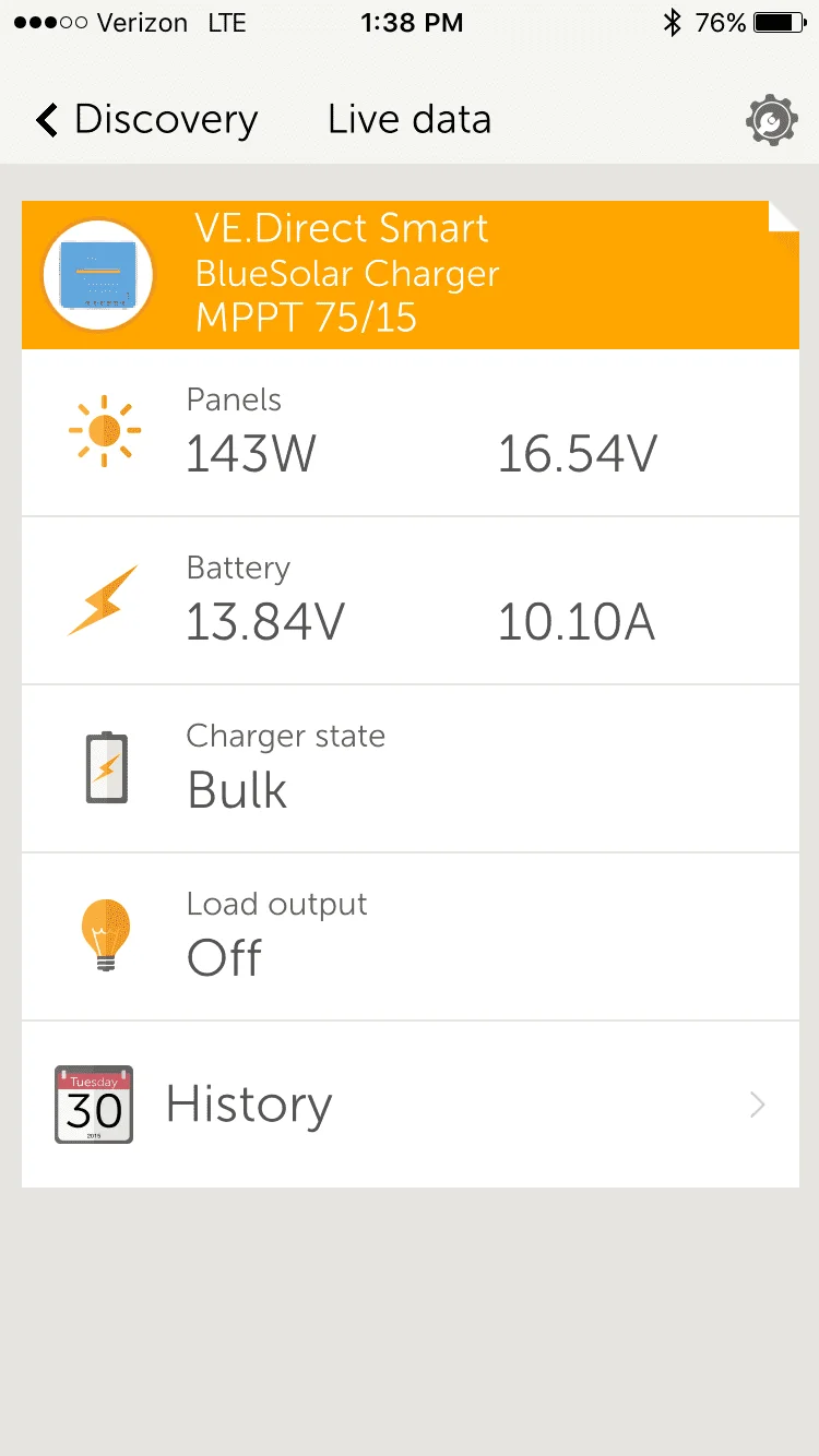

If you ended up buying the bluetooth charge controller from Victron, it gives you a nice read out of panel output and battery voltage on the phone app.
I haven’t yet. With a 160w panel the 75/15 should be adequate, correct?
Will be fine. The interface was upgraded with the last update. But you get the idea.

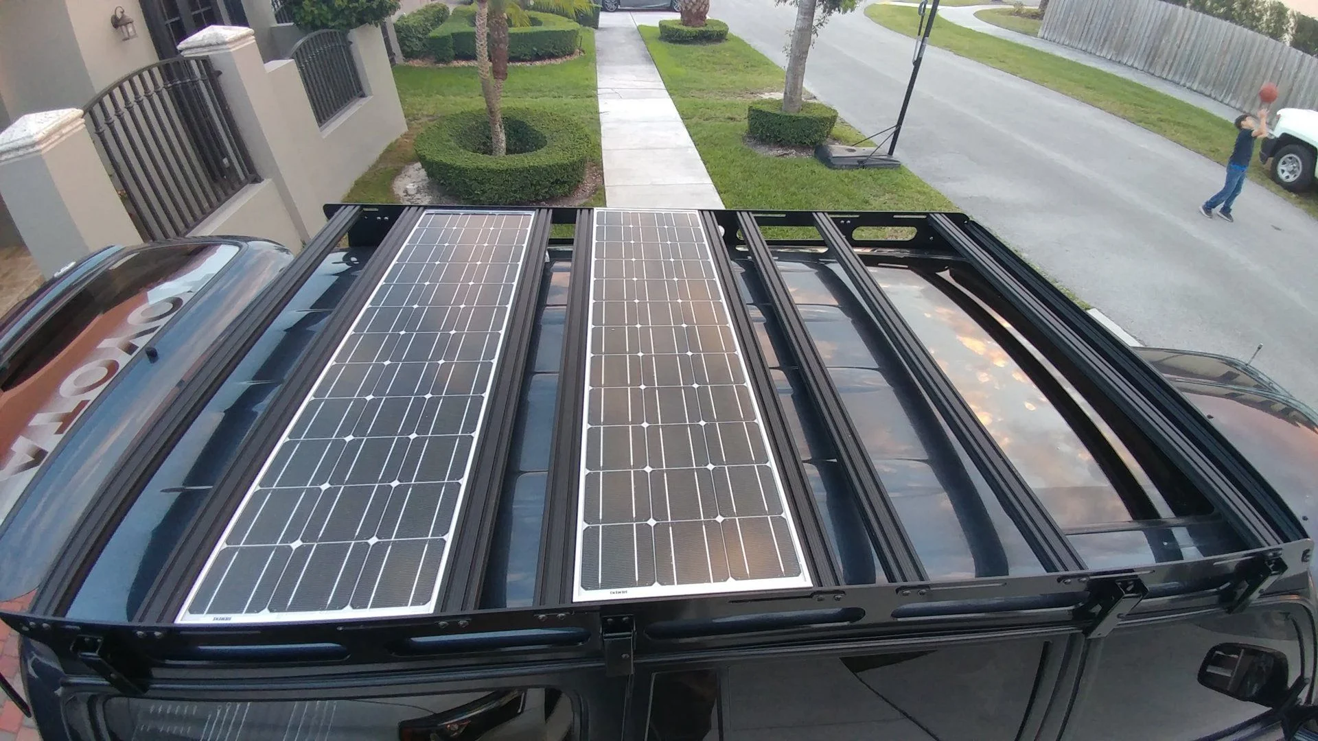

Never got to finish the install. Convinced myself into getting a hardshell roof tent. Was coming out sweet tho.
@fj62max that is a nice clean install. Looks great actually.
What panels are those? Long and skinny is unusual.
