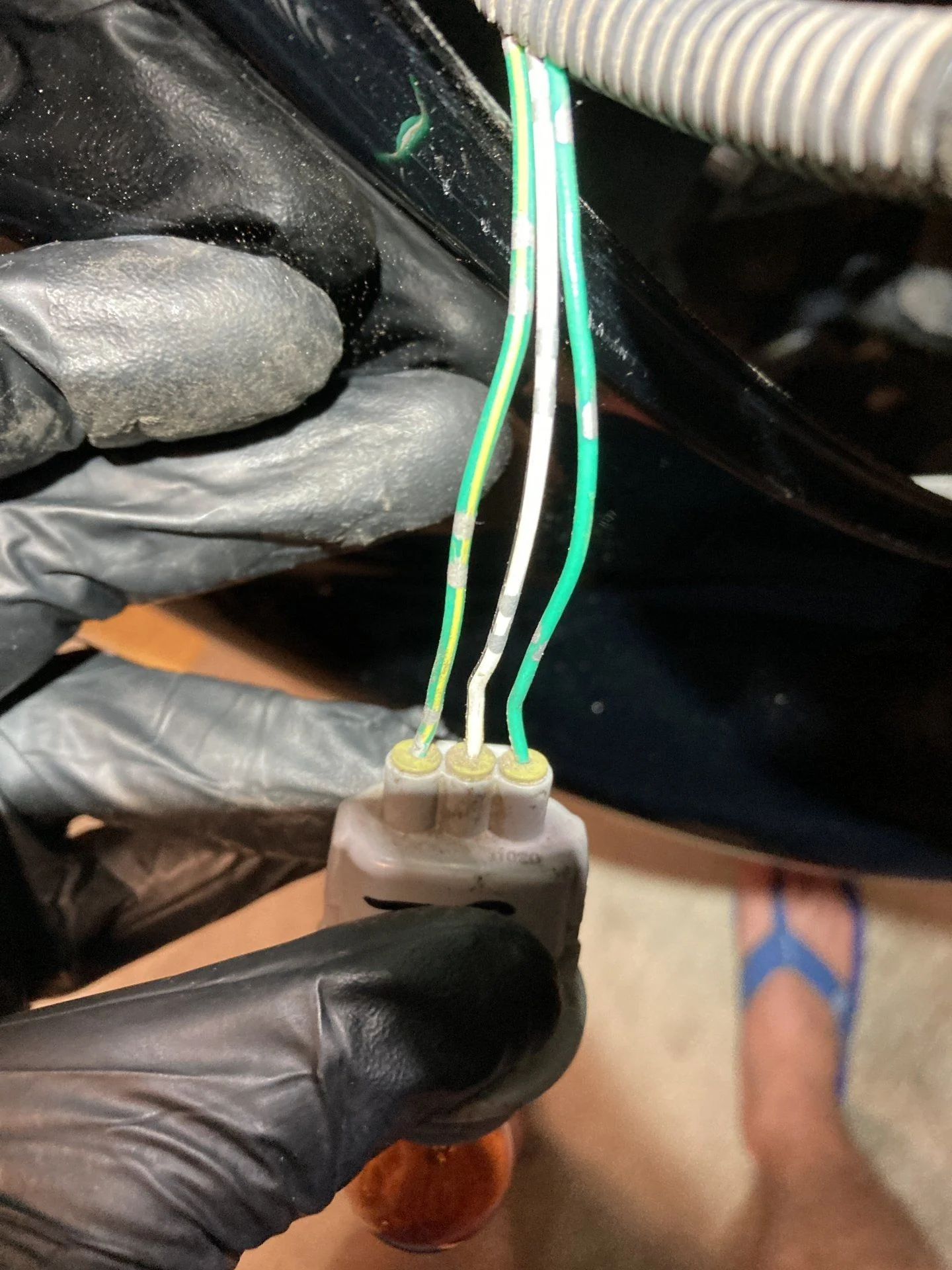

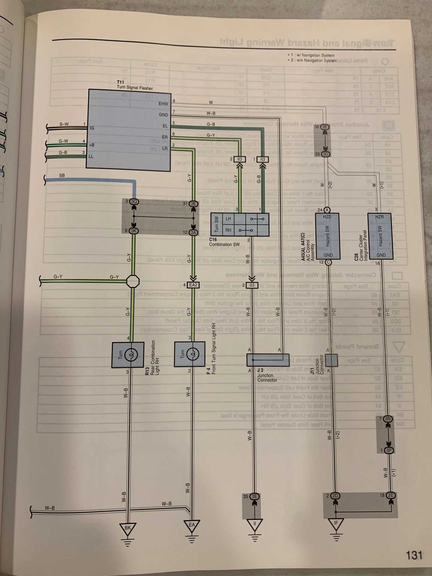

There are three wires coming into the front bulb housings. Anyone happen to know which of the two positives do what, based on their color and marking?

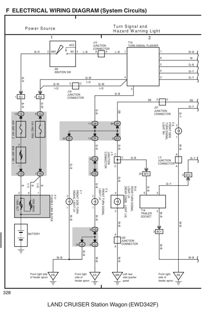

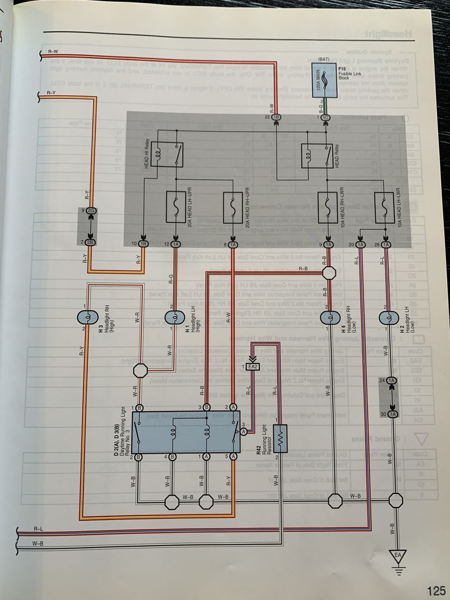

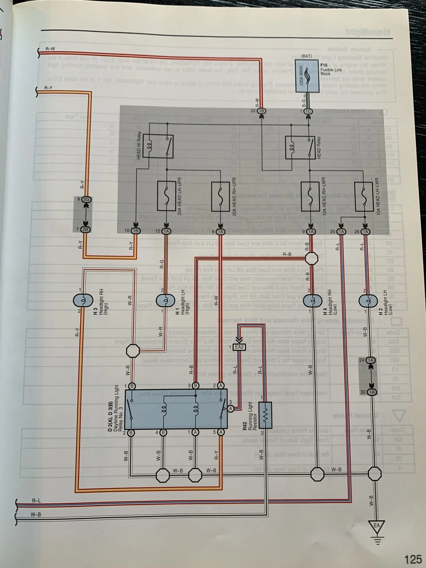

Thank you sir. I love how it's called a Station Wagon in the EWD. The "HEADLIGHT W/ DRL" diagrams only go to 2002... does that mean it's the same for 2004+, or is there another manual that covers that? The hazard signals, and beam level diagrams are provided for 2004+.

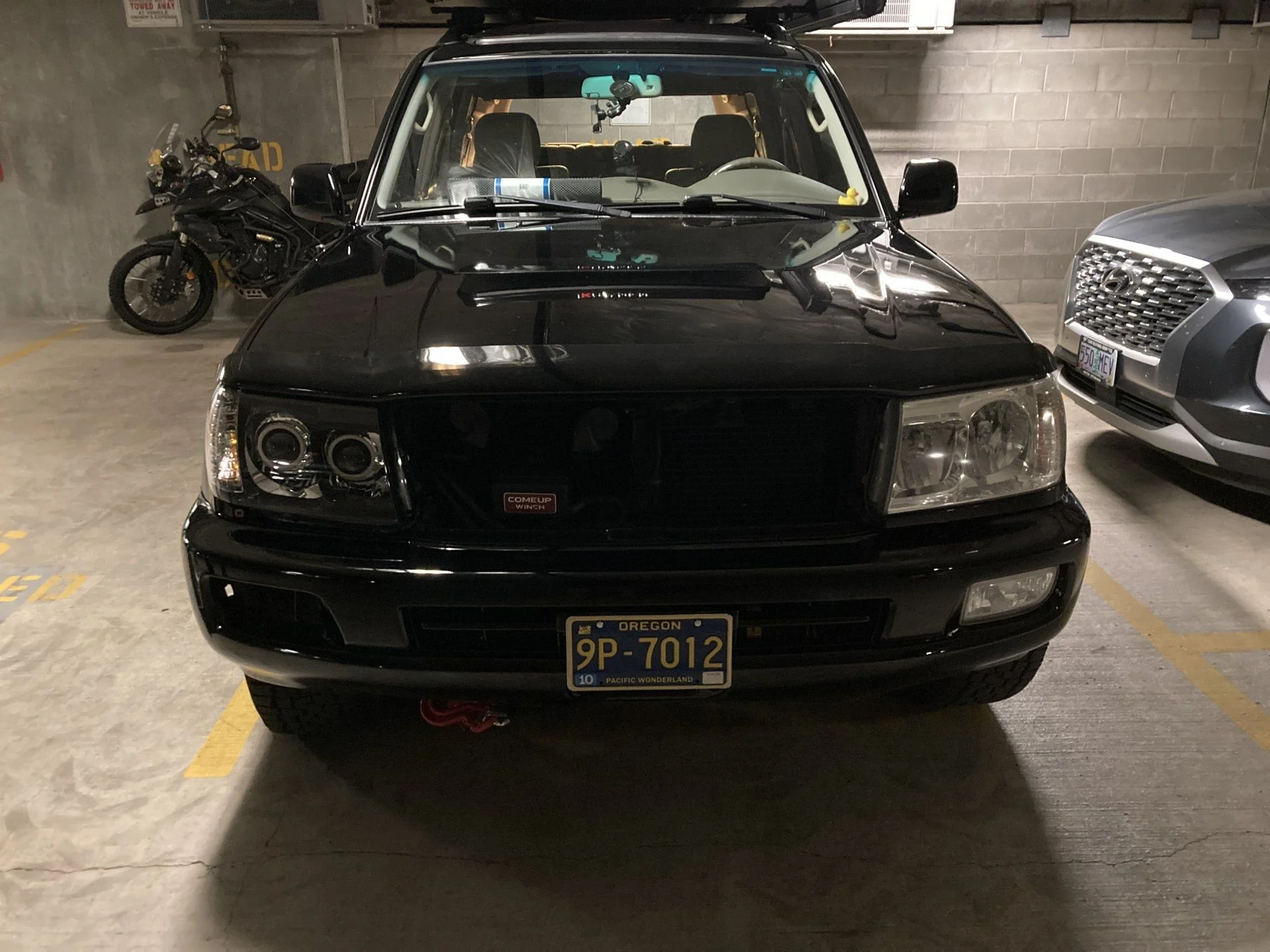

I'm wiring up some fancy new headlights with halos, and it's proving to be much more complicated than I thought to wire up the halos. Wiring on left and right for DRL seems to be different. Going to be cool when I figure it out, though!
I’m not sure what the wiring differences are after 2004. I do know the headlights for 06-07 are different than earlier years, so very well might be different wiring schematic.

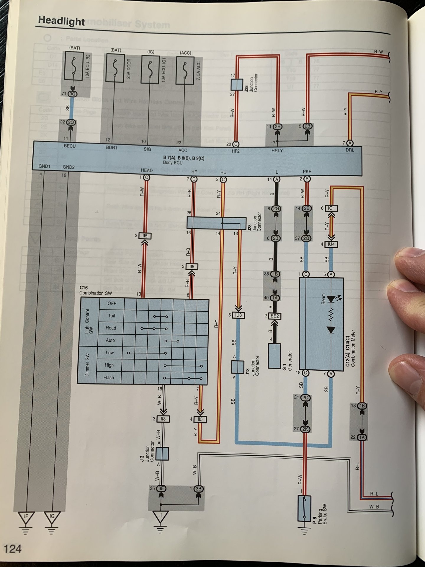

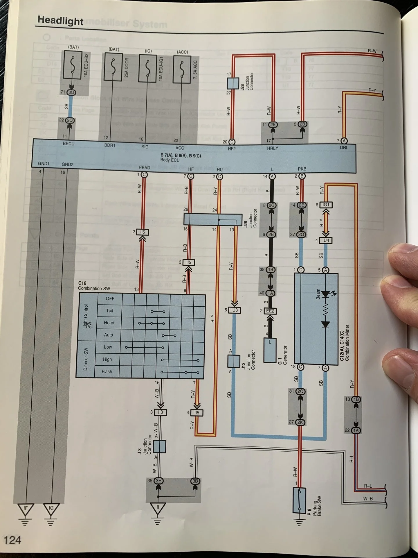

Hooking up some new halos and quad projectors on my 06, and needing diagrams for the "HEADLIGHT w/ DAYTIME RUNNNING LIGHTS.
Thanks~
Putting some new projectors and DRL halo's on my 06, and needing to sort out how the Daytime Running Lights are wired. Other posted EWDs only show that Headlights w/ DRL section to 2002...
Thanks!

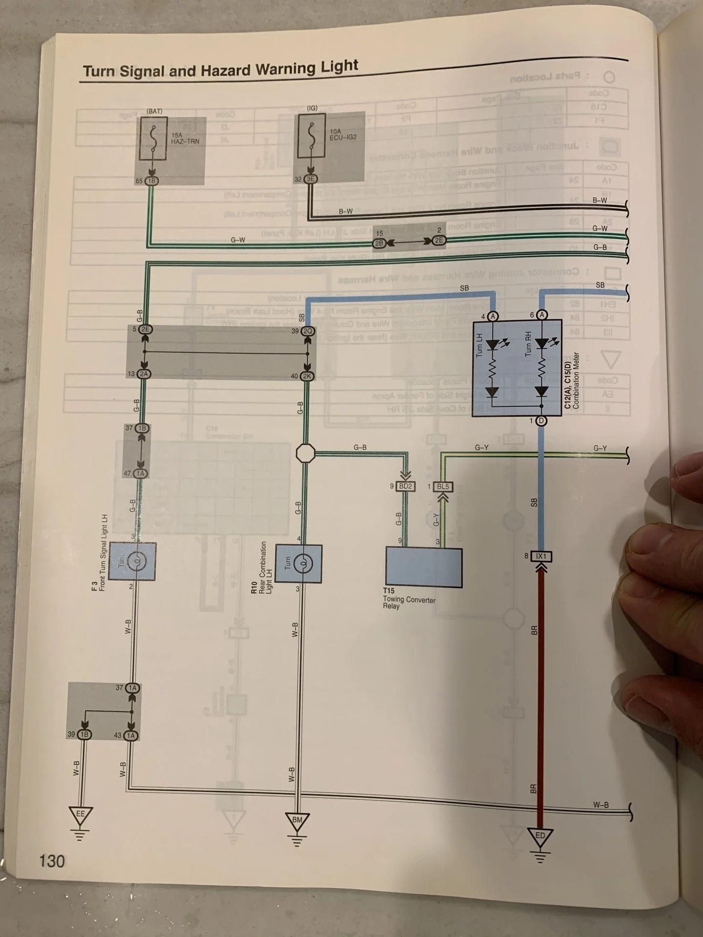

I have the '04 EWD, would that be any help?
From the ‘07 land cruiser EWD
aging fleet! yes, 07 is great. turns out the pages i really need are the ones that deal with the HEADLIGHTS RHS, and HEADLIGHTS W/DAYTIME RUNNING LIGHTS LHD. could you pretty please post those???!!!
