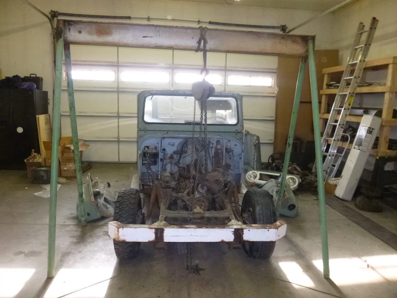

I have a pretty REDNECK version that I built years ago with a 2Ton chain fall (overkill--just what I had laying around)... Awesome for pulling motors, tubs and bodies.. I also use it for loading heavy objects and pallets into the back of pickups etc.... mine is 8' tall.

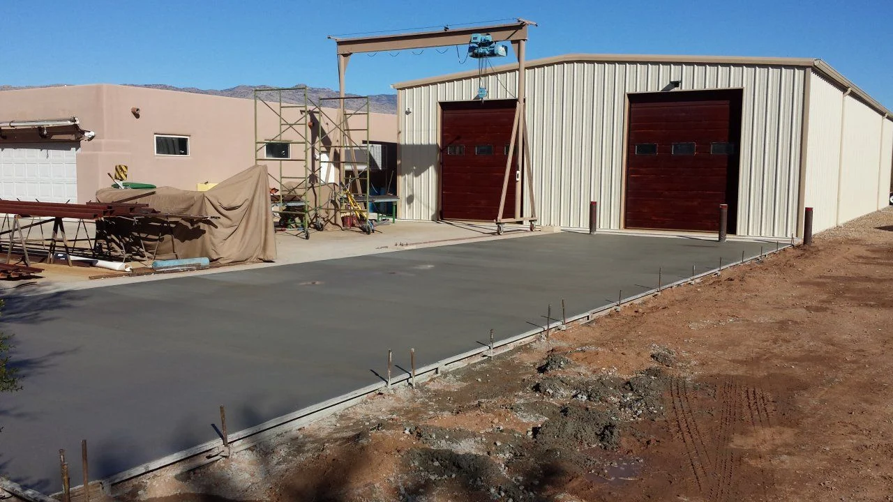

I have a Gantry crane, but not an import. It's rated for 5 tons (shaw box). I rarely use it these days as the fork lift is more flexible. In the shop I have a 10k two post lift, so the gantry has become some what of yard art. I entertain the thought of selling the gantry but the big ass barn owls that perch up there at night would be devastated. haha
That's exactly what I want one for, so good to know it can handle that. How difficult is it to raise and lower the pulley? if it was around a tub, where would you pull it from? I assume the hoist would be centered. Do you pull it from the side with a long chain?
J,
With a chain fall it is just a matter of pulling on the chain.. the gear reduction seems like 50:1 to me.. slow, but progressive and gets the job done.. faster you pull on the chain.. the faster the lift.
I wish I had taken pictures yesterday when I pulled my tub and sat it on stands.. weight to center varies pending the cruiser/object.. I was close to centered on the 40 tub. When you start lifting, you will know, and adjust your straps/cable /chain as needed..
J
Ah, thanks J, I wasn't aware that it was a gear reduction, so that makes it much easier.
J, are those legs attached to the floor? I'd be afraid of them spreading apart with a heavy load.

Those legs are 2" Sch 160 seamless tubing with 3 passes of 10018 low-hy rod on the I-Beam... I'm not scared at ALL... I actually tested it and picked up a full pallet of blast sand after I made it... It just laughed at me...

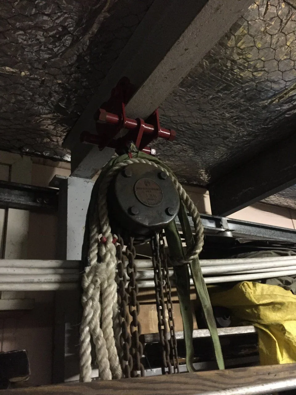

When I built my shed I installed this beam and trolley with the 1 ton block. The beam was rated at 4 ton and is 8 foot high.
