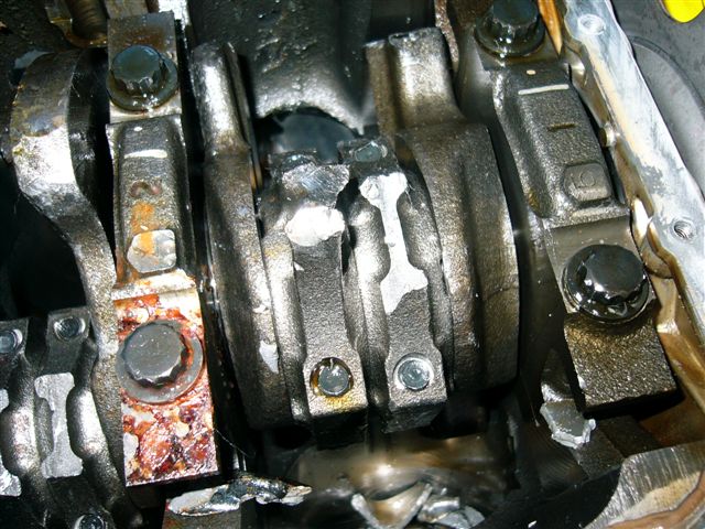

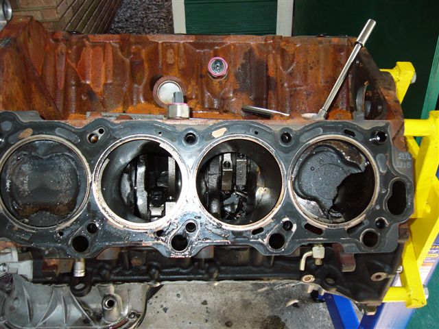

Here is one example from one of our members:
