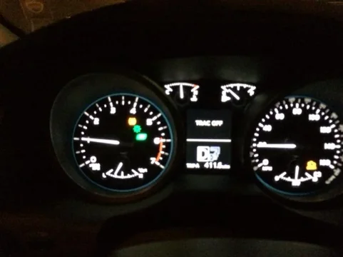

4low flashing and check engine light with Trac off
Hi There I had the 4 low flashing with check CSC system. I recall it was error code P033 which means knock sensor or a short in the knock sensor.
Mine ended up being a cut wire of knock sensor # 4. These sensors are located under the manifold there are 4 of them.
I have another post showing the cut wire and the locstion.
Thanks

Yep
When the dealer changed the oil they turned the supercharger off.
Thanks
Limp mode sucks btw
Yep
Thanks
Limp mode sucks btw
