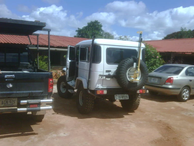

I saw a picture of a south american Bandi with a raised exhaust...anyone here in the states do this? If so, let see some pictures...

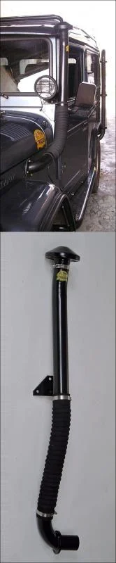

It is a more permanent solution to what the Army used to call a water fording package. I have crossed some pretty deep streams and no problems. However guys right behind me who failed to keep the bow wave out front, drove too slow, let water get into the exhaust and drowned their rigs. You MIGHT need a temporary version of that if you live near and ford deep water a couple times a year. As someone said unless you do deep water fording on a daily basis there is no reason to make that permanent. All that said this guy did a very nice job on the install.:cheers:
I like the one in the photo, but a couple more inches between ladder & exhaust would help climbing.

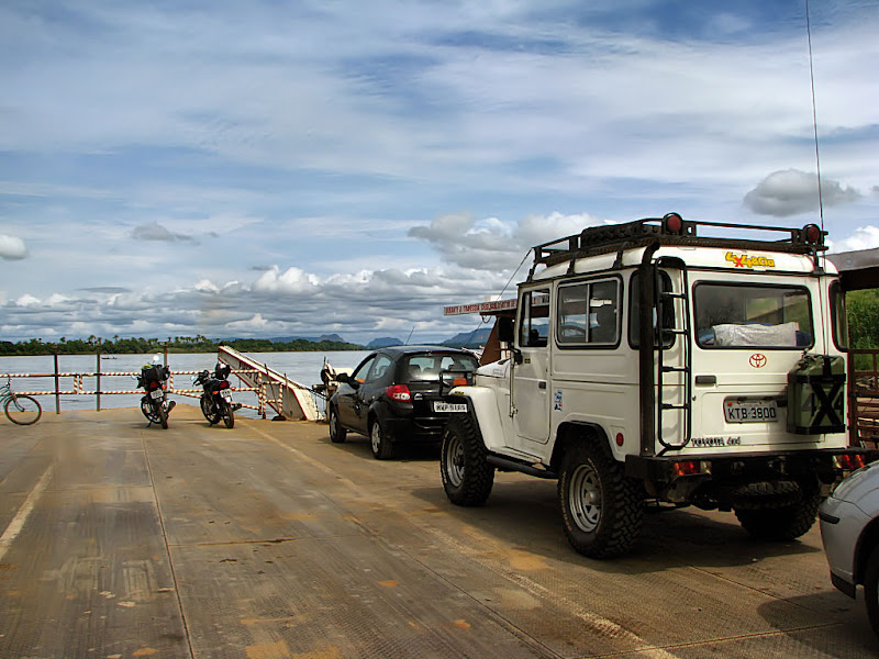

Here is another picture of the Bandi

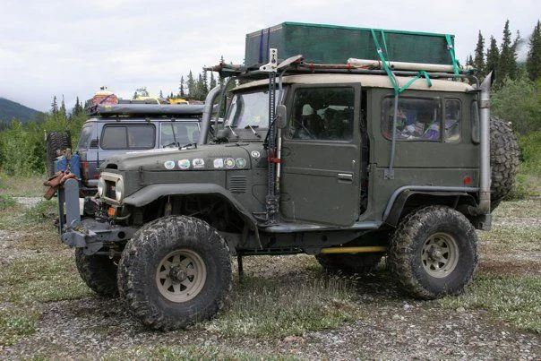

FJ40 from Alaska Trek 2010...check expeditions for more inf on the owner

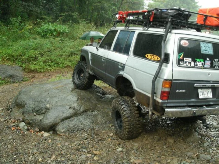

FJ60 in Puerto Rico..photo out on facebook
If i move back to Puerto Rico i will do the snorkel just to use in raining or in hurricane seasons
that fj60 belong to a friend in pr,i guess the rack and all that is home made,but im sure the for the high lift mount there a few places on line that they have it
