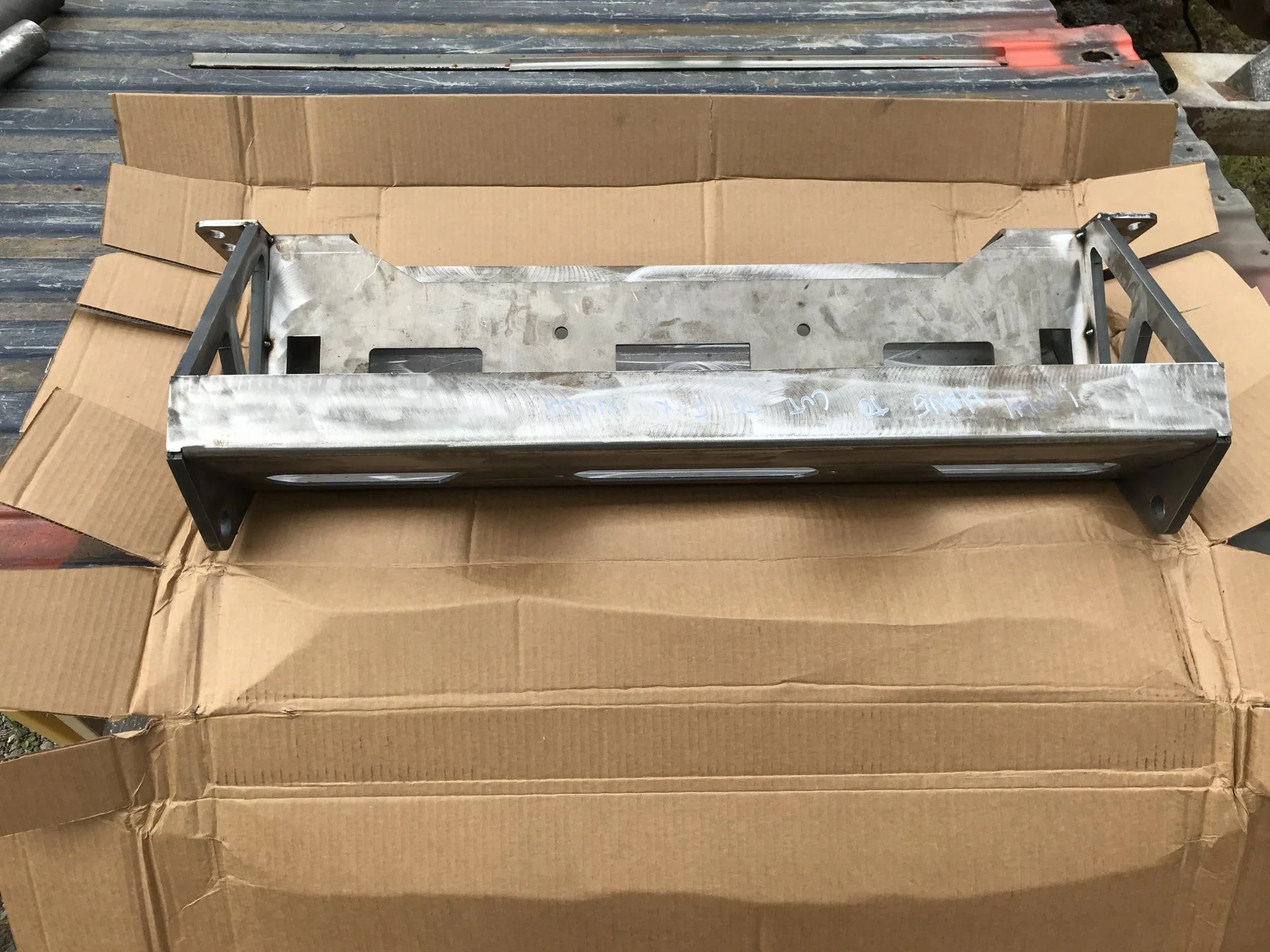

What I got based on my request & knowing I don’t need a bumper skin crossing the border was this:
What you’re looking at may not seem like much - but it’s 100% as I asked from them. It’ll hold my winch & it’s just stitch-welded if I need bend anything or whatever between install & winch mounting.
And I got it some ~72hrs from making the solution to when it landed via the UPS carrier.
Jason (the owner) - stated I should see a bumper before my 2nd/last fish trip up the same route at the very tail of July or early single-digit days of August, so I can live with going skinless bumper up front for ~2mo.
Both he & esp his welder Cy get props from me - Cy did exactly as I asked since I wasn’t sure on fit between the frame horns or me trying to stuff a Zeon 10K into it.

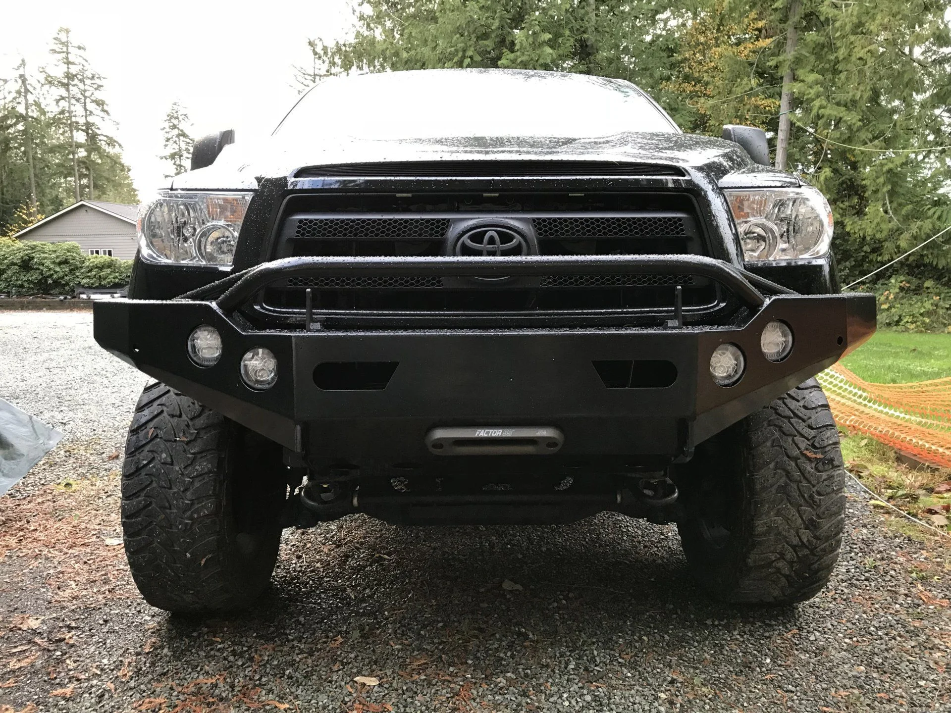

So 3 of 4 round lights are in, the light bar doesn’t clear the hood on the hinges if I want it to sit anything behind the grill bar (not a big deal to me, I was so-so on the bar anyhow), and the winch is just bolted in with no power or rope on the spool.
So current look:

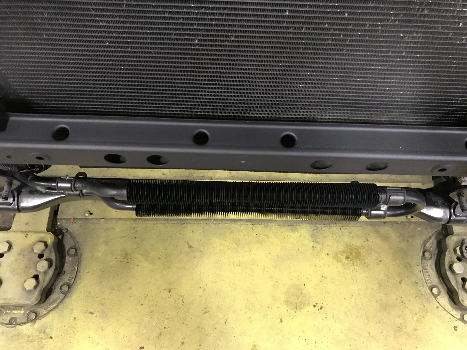

Before I forget the little stuff of the install, the bumper isn’t built to fit with the tow package / trans cooler (pretty sure it’s the trans cooler, but mebbe the PS cooler, I was mission driven & wasn’t out to fiddle with figuring stuff out) - you have to remove the bars that hold it & redrill the holes for the mount arm bolts back all of 3/8”-1/2” so you don’t crush the fins and have it constantly rubbing the bumper.
I’ll edit this post with a downward pic, it’ll show how mine is clearanced now due to that 1/2” backspace I did (rebolting them is tricky when drilled, so you know).
Pic showing what I’m saying, the shot is from RS angled to center, shows the fit between the body & bumper w/ that backset:
Vs the stock space the factory cooler gap is:

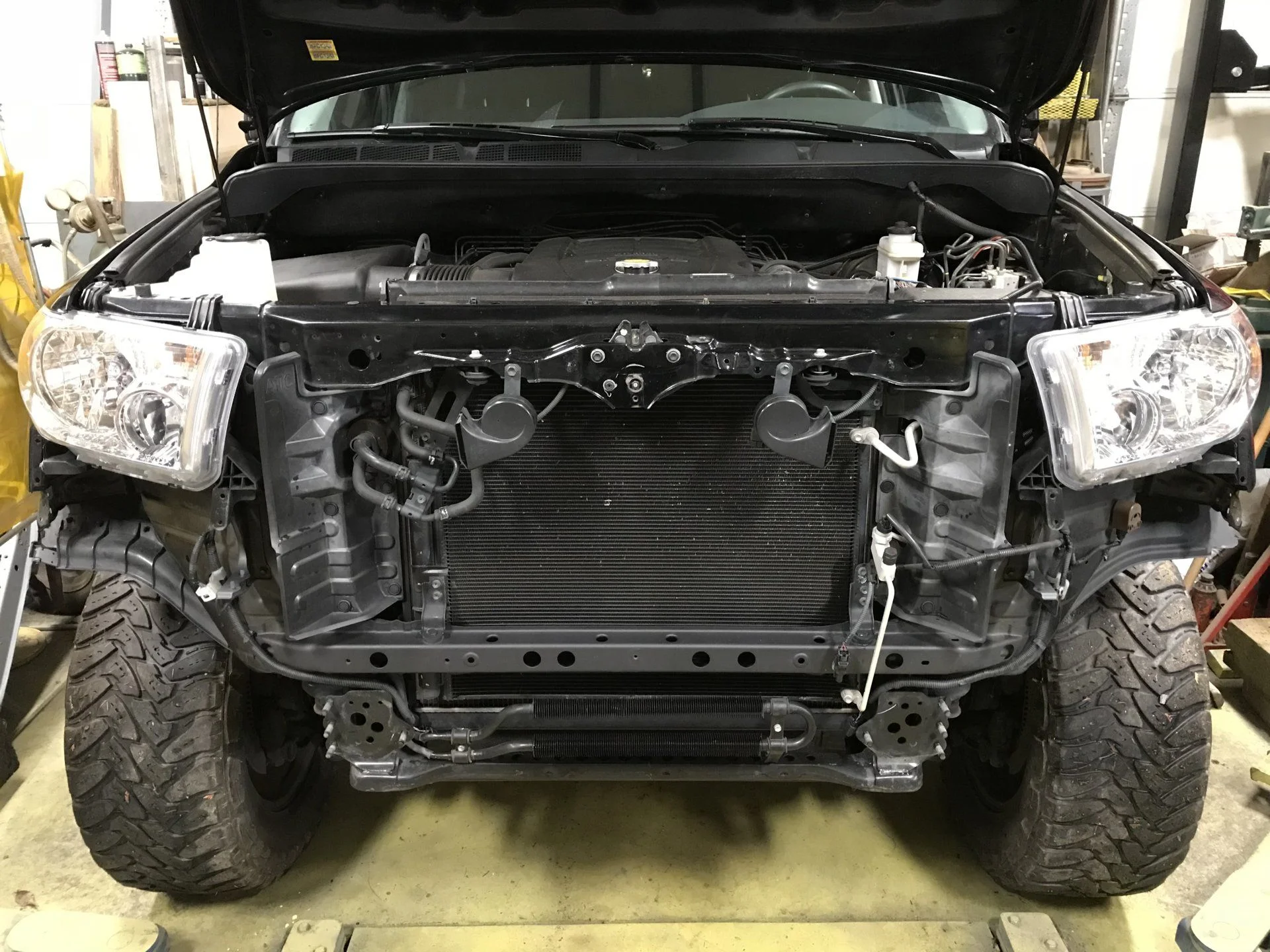

You will need to strip the front end down to this point, so you know what all comes off to do this bumper:

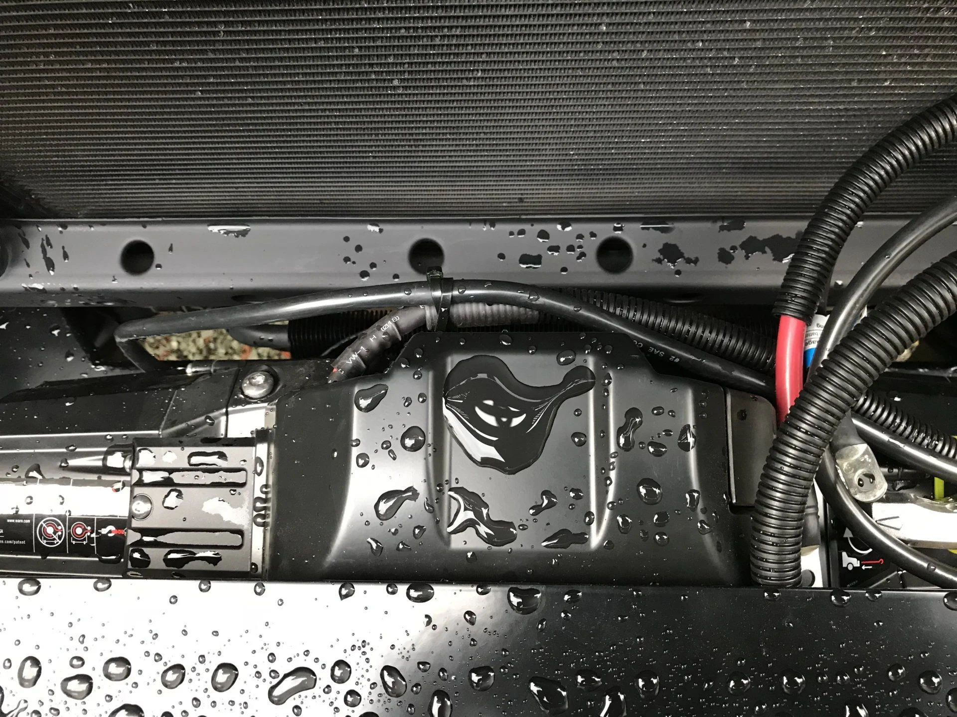

Pic to show Warn Zeon without any mods & clearance, and why the bumperskin bar is still out:
That gap between the solenoid & bumper is barely 3/16”, and the curve matters as the solenoid is taller than the bumper behind where the top bumper sheet metal stops.
