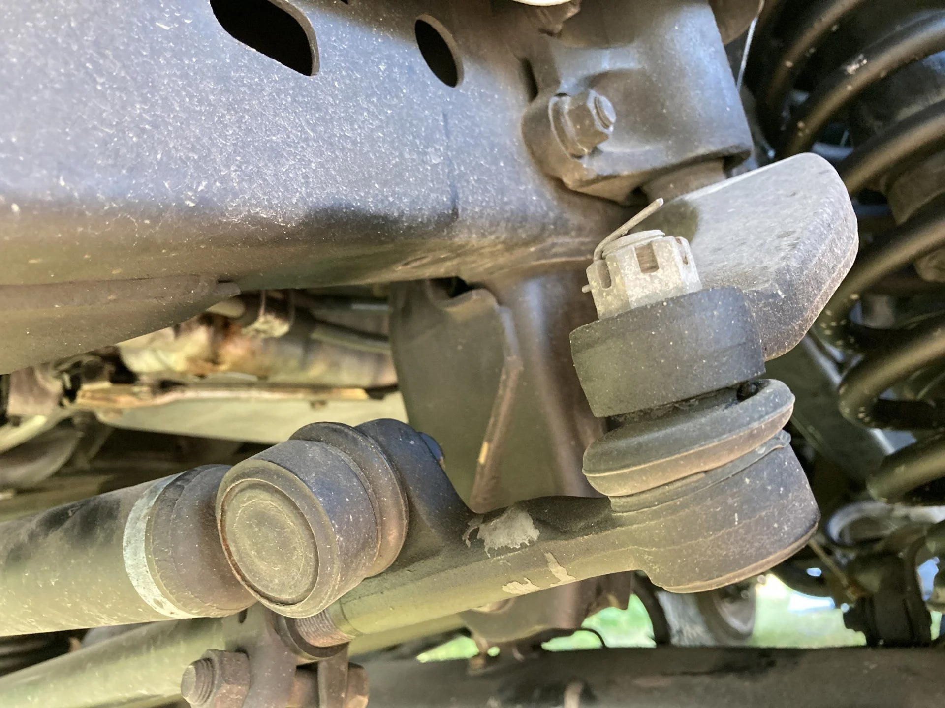

The pickle fork and a BFH are your friends here, use a light touch until you can't avoid it, but you've been doing right by juicing it. Should be a quick job, but my tech makes such things look quick and easy when I might take all day.
I did mine while replacing some other stuff so I had the radiator, shroud and fan out. I sprayed it the day before with Corrosion-X. I hit the bolt a few times from above with a 3 lb mini sledge and the pin popped right out.

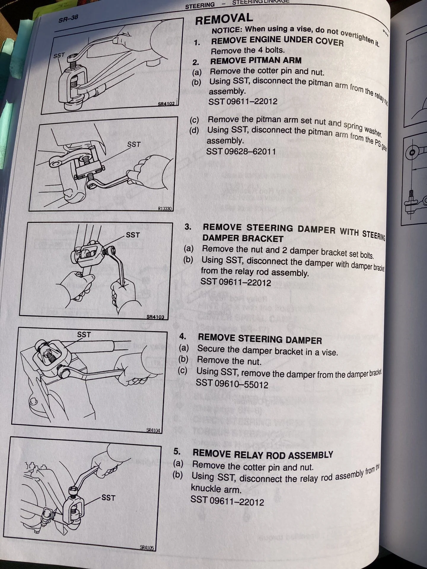

also i went through the FSM truce in suspension and axle chapter. i don’t see it in the table of contents or in any off the illustrations.

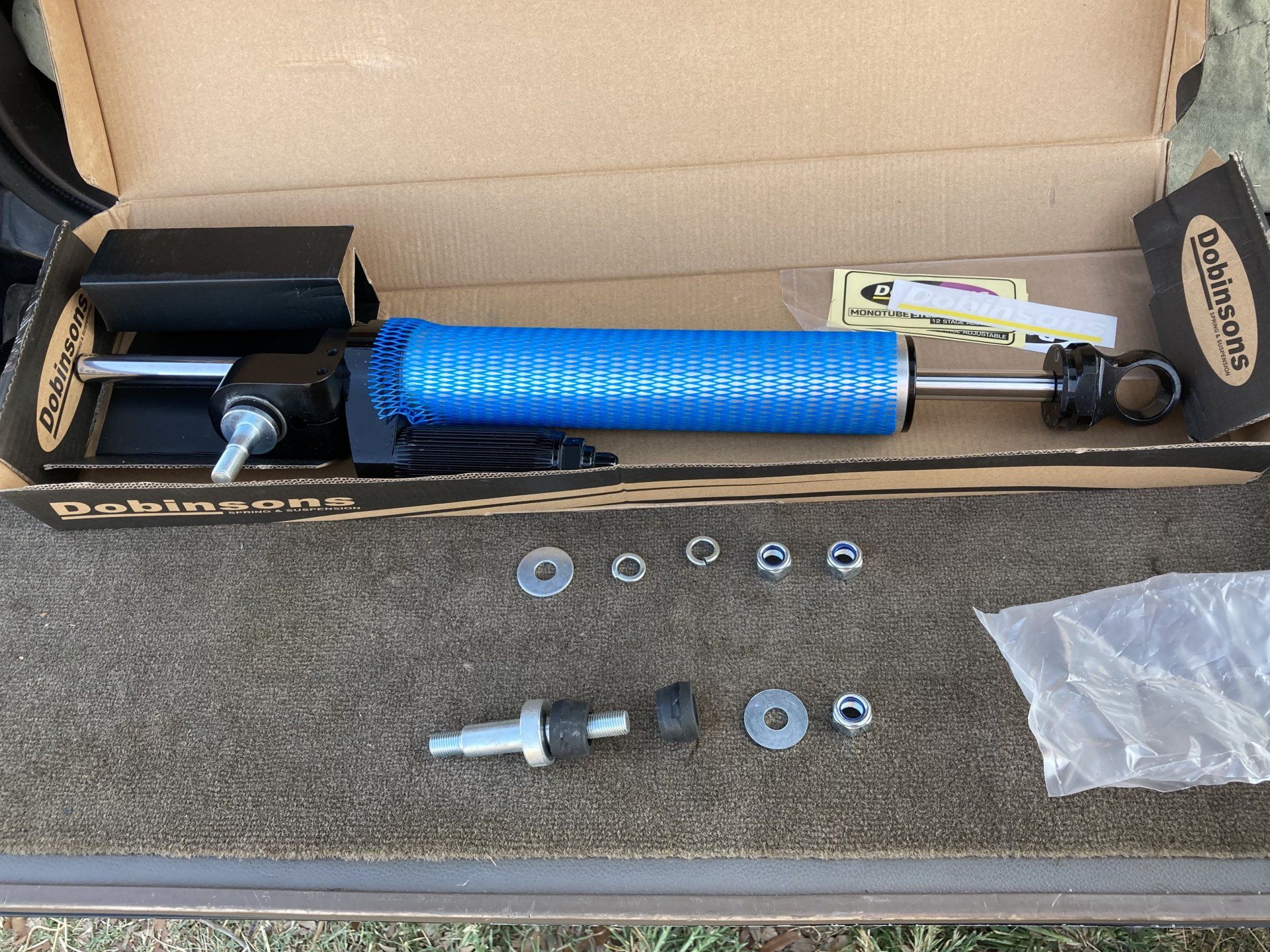

so anyone see anything here in terms of knocking out the pins? or happen to know the order of install for the hardware on this dobinson kit? or see anything else i might be missing?
i am really hoping to “measure truce and cut once” on this one...
Check pages SR-39 to SR-42. They use a SST, but not strictly necessary. Also, they remove the bracket from the old and install it to the new damper before bolting to the relay rod.
Use a pickle fork....or an SST if you have one.
If you spent the silly $400 on that damper, you should have just got a new mount from Toyota, 4572160090, it's like $25 (if it's still available).

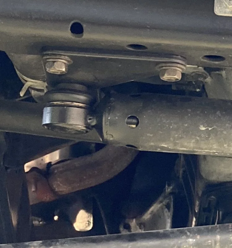

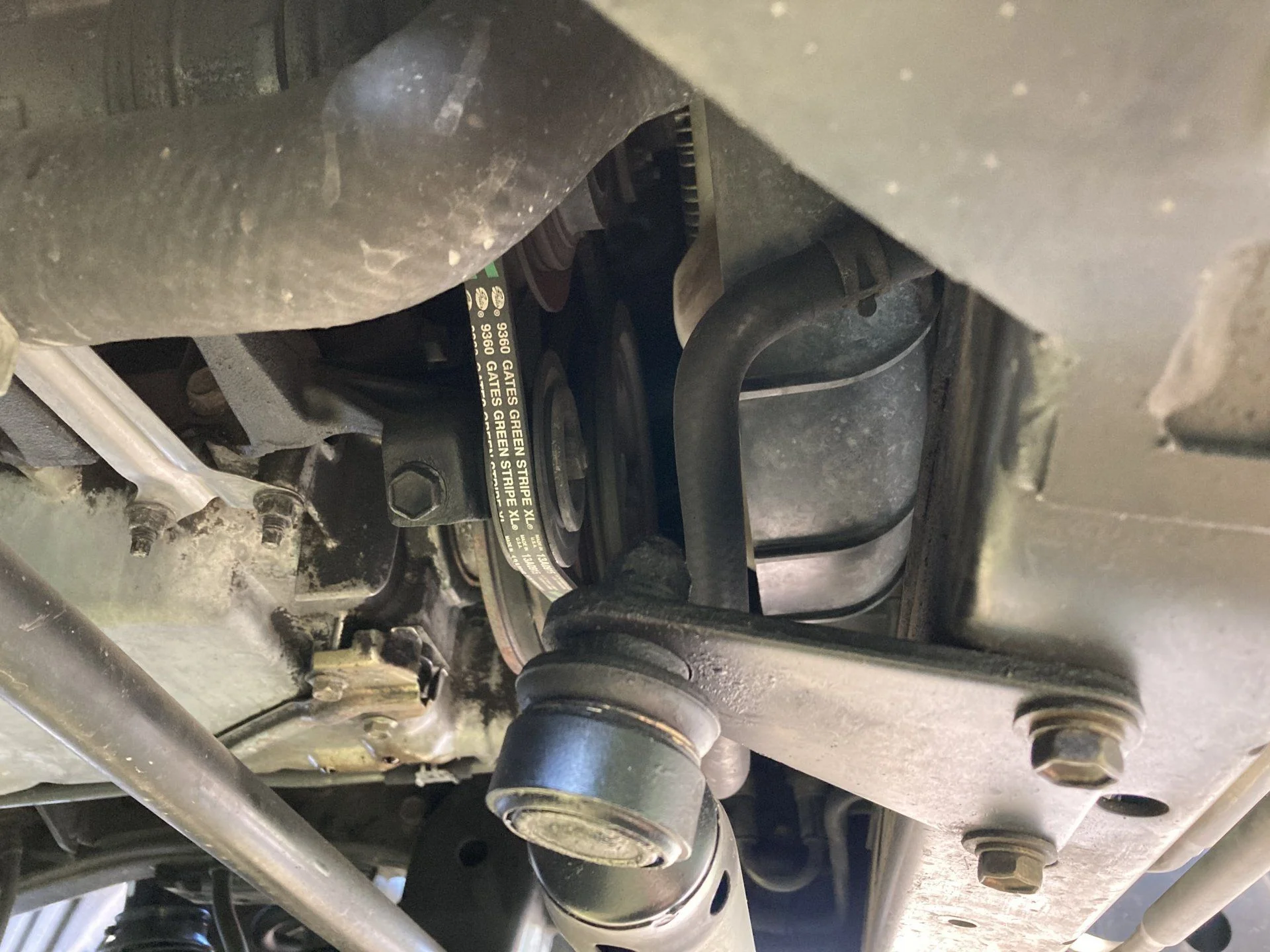

Otherwise, here is tip to make life easy when using the "SST" or likes: Remove the two bolts from the frame, rotate and flip (obviously while still attached to the original damper) and re-install. This will give you bottom access to the mounting bolt and tapered stud, or "pin" as you called it. Don't follow the FSM and expect to have an easy time trying to remove the tapered stud from the mount while mounted in a vice.

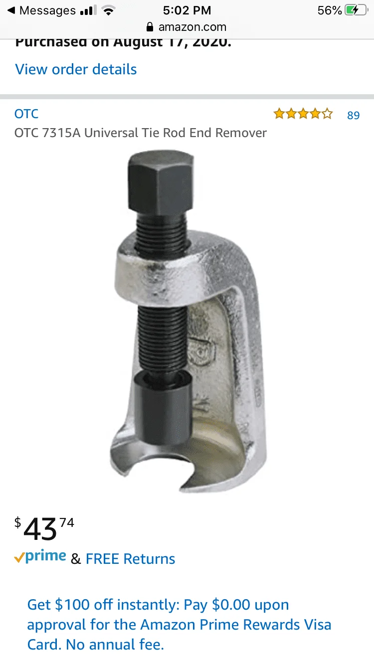

Pickle fork should be last resort as they damage things. Use a proper balljoint or tie-rod end tool if you have one. I've been using tools out of an OTC # 6295 front-end toolset recently with the work I'm doing on the front end of my 80. But there are generic pitman/tie-rod/balljoint tools around just as good.
thanks dude. i bought this one this afternoon so i guess i skip the pickle fork? it’s a bit of a tall order learning the terminology...
THANKS. here is a link to those: Amazon product ASIN B0002SRH7O
This and a couple wrenches is all you need. 15 minute job. Don’t use the tie rod tool on the truck, pull the whole thing off, then use the tool. Then reassembly is the reverse.
When I took the original OEM one off, I sprayed Deep Creep on the pins for a day or two then used a 42" Dewalt "wrecking bar" between the frame and damper, popped right out.

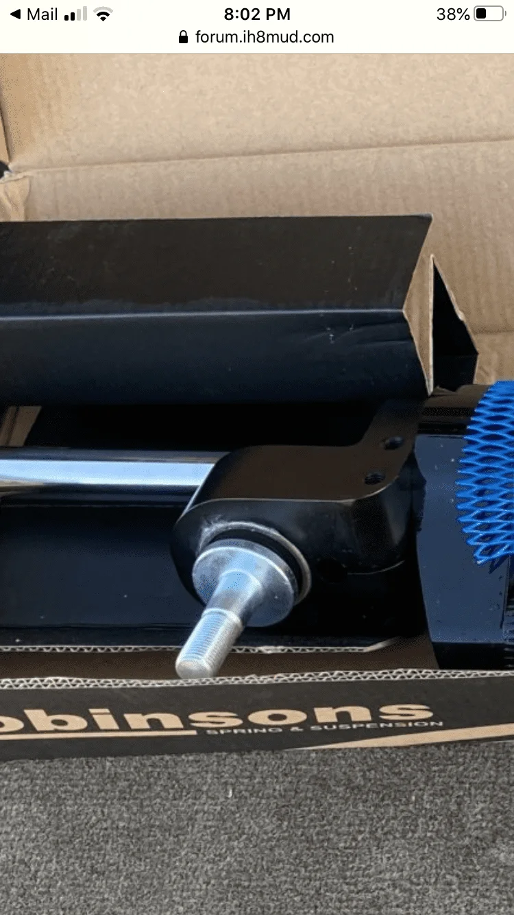

thanks man. i found a video. but this dobinson stuff does not come with very good instructions.

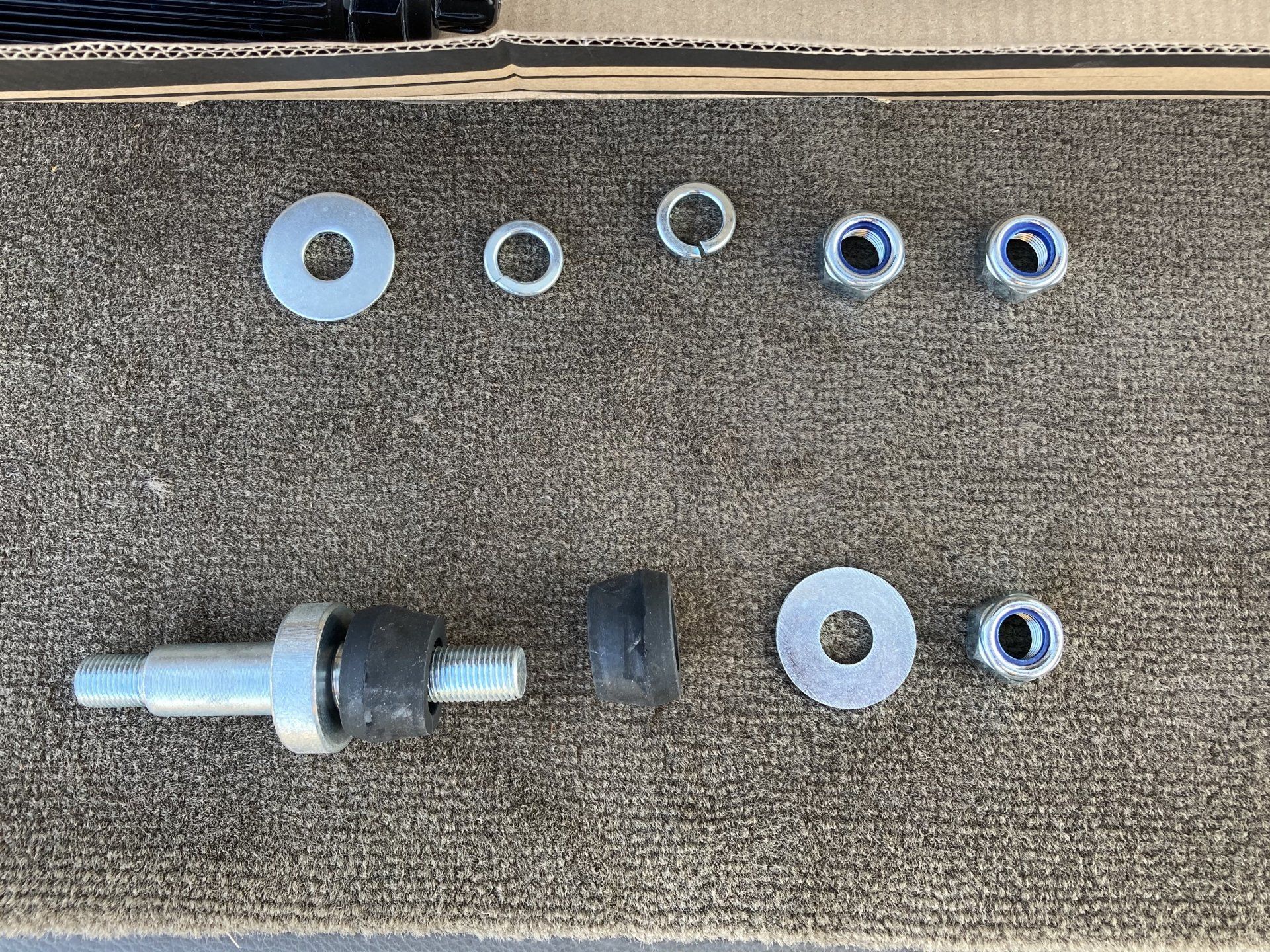

do you happen to know if this end goes DS i assume? and it just bolts up with a - well like a big washer and then the helical spring washer and then a nut?
