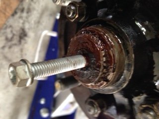

last point... the hole in the end of the axle is threaded and a bolt threaded into it makes it easy to pull it out and keep it out while you re-install the C clip... again thanks for the help and info.
