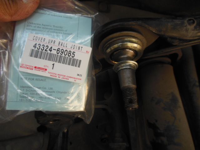

Saw a rip between two bellows in the upper ball joint. Any body found any remedy to fix it? Ball joint is still good, no free play. Same with the bushings...
Found 43324-69085 but it looks like for Prado.
BJ boots are replaceable
Upper: your google fu is correct

McGrerge has it for a $8.50! Two in the cart! Thanks abuck99!!

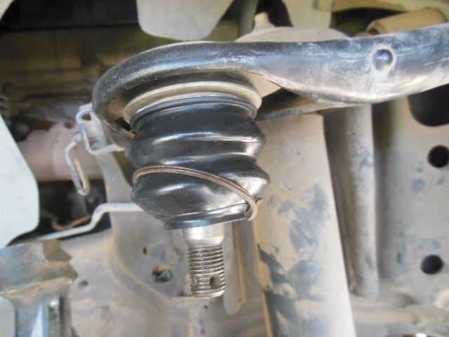

Got the boots today and the installation was not as bad as I thought.
I had the grease on the joint and then slide in the boot and then moved the ring (used old ring as it seems much sturdier) through the bellows. The spring went in smoothly, had to lift one-end with a blunt screwdriver.
Place the ends of the spring facing the front of the LC (not shown) to avoid touching the rubber boot
The boot is made by NOK, the same brand that makes OEM TOYOTA oil seals
Done
