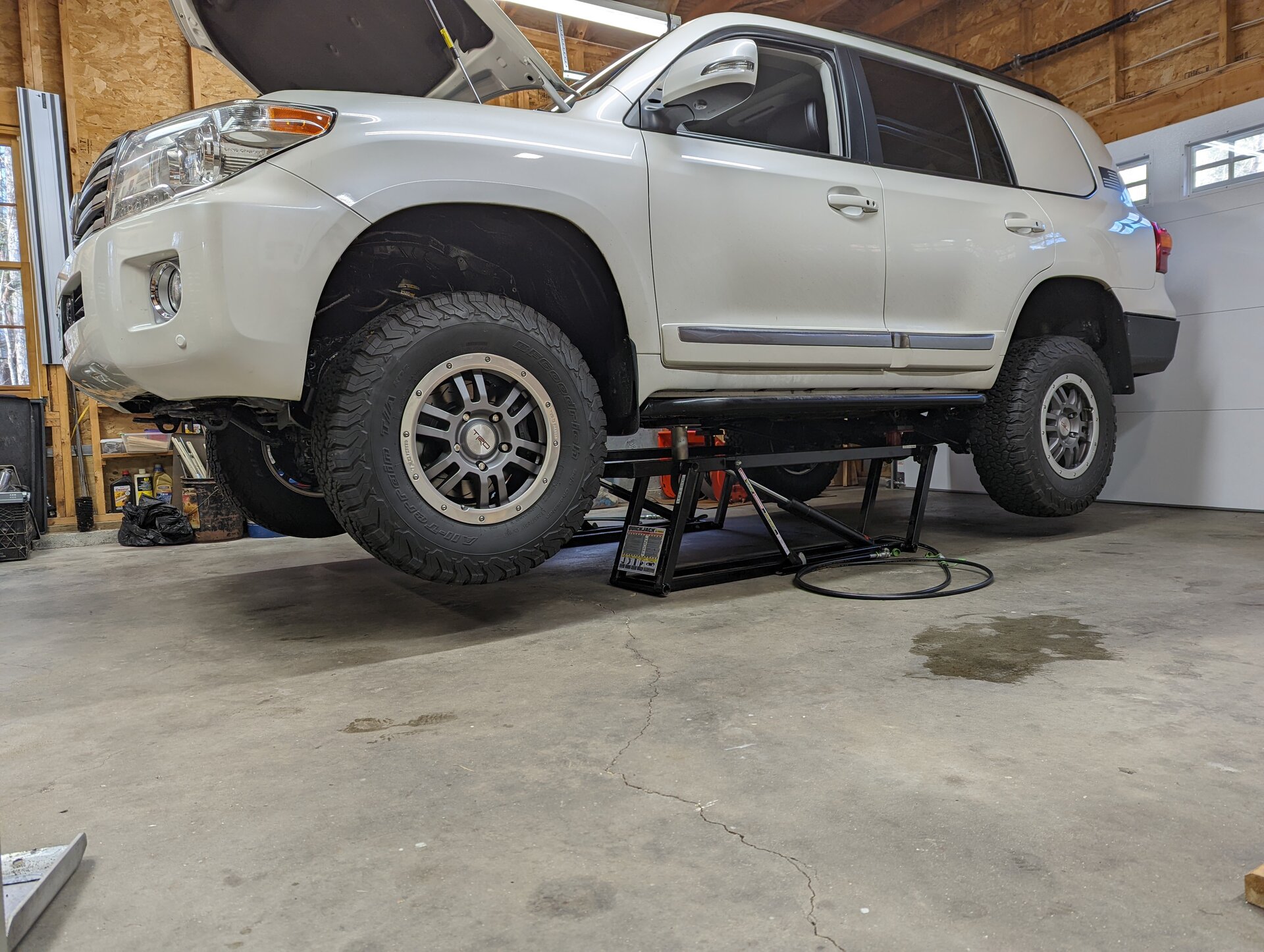

I bought a Quickjack 7000 during a Costco sale and it was so heavy I couldn’t use it. I sold it brand new through a Mud connection. For me It was way more cumbersome than simply using Rhino ramps or floor jack with stands depending on the job. Member @KLF has one, but he’s a lot younger and stronger than me. Here’s his.

OT (with apologies):
Where did you get those blank panels for the cargo area side windows? What a great add-on!

It's just Avery film/wrap. I bought a 2' x 5' piece, it just barely covered the windows. It was mostly an experiment to improve privacy, but I do like it so it's still on 5 years later.

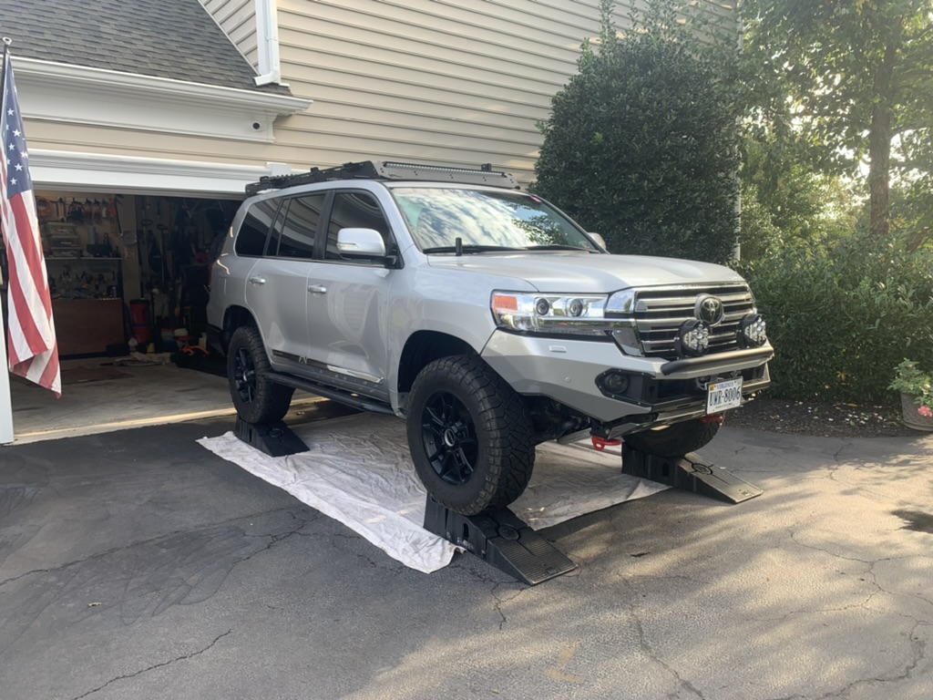

When I do the annual undercoating (woolwax, Fluid Film, Corrosion Free etc.), I use ramps. Easier to clean them then getting all that mess on the QuickJacks. It's also easier to move around and apply under the sliders and sides.

Hmmm……is it easier to reverse up the ramps?

As said, the issue shown in the video above was entirely user error, not a fault of the QuickJack. Used and maintained properly, it won't do that, no way.
Once the vehicle is lifted and the safety bars engaged, hydraulics are no longer holding the load, it's very simple and safe. In fact, you put it in "safe" position by releasing the hydraulics, then you can even disconnect the hoses.
I have absolutely no concerns about being under my 200 when raised on my QuicjJacks. It's very stable, it may actually be more stable than on jack stands. Yup, BendPak haa a video where they stack over 20,000 lbs on a 5,000 unit and it LIFTS it up (they had to use a special pump).
Are they perfect? Nope. They are heavy and awkward to move the frames around. The wheels on the ends suck, but fortunately they can be replaced with better ones from Amazon. They really need casters. The hoses are a pain to get routed. They certainly won't replace a real 2-post lift, that's for sure.
