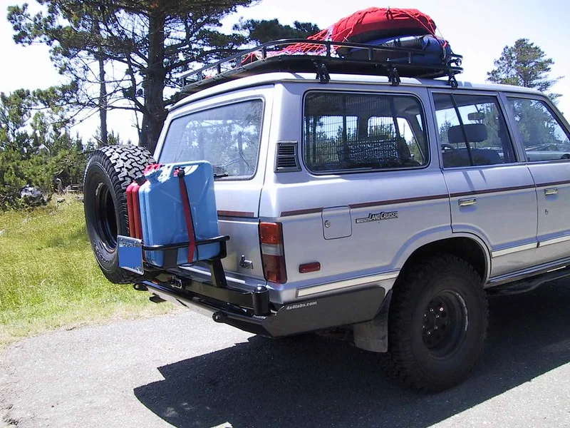

I have a 4+ dual rear swing-out on my 40 that carries a spare, three Scepter jerry cans (or a Coleman cooler), a Hi-lift jack, and two radio antennas. There's no doubt it's heavy when fully-loaded for a week in the back country. The first time I used it that way, it really compressed my back lift springs (probably didn't account for enough weight in the design of the lift). The 4+ bumper is heavy duty, and heavy in its own right. I added some helper leaves to my rear springs, and never load up the jerry cans and Hi-lift unless I really need them.
Having said that, I still think the rear bumper is the easiest and best way to carry spare fuel and water, when you need to.

@2mbb Thanks for that picture. That clearly illustrates the "problem" circling around in my head about fabbing one up. That looks like a lot of potential strain on welds that join the vertical tube to the horizontal. That seems to be how most cage style (not built form flat stock) carriers are constructed though so it's probably fine.
some of that is mitgated by using gussets. It's hard to tell but these gussets go across the swing arm at 45deg and angle on the upright from the inside edge at the top to the outside edge at the bottom. This "triangulation" probably stiffens the upright quite a bit.
If it works, it works. I don't have the chops to re-invent the wheel here, but I can certainly add some gussets to what I've been seeing in my head.
