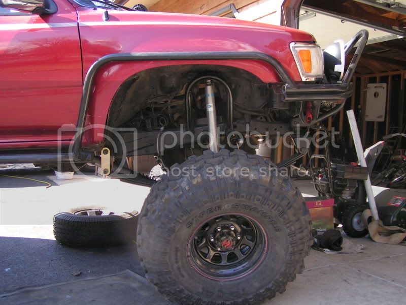

btw, what trans/t-case do you run, and what front springs? how much lift? can i see a pic that shows its ride height?
It was a 3'' kit from TG it put me up about 6-7'' so we took a leaf out of the front leaf pack that lowered it 2'' and 5'' of block in the rear leveled it pretty close
