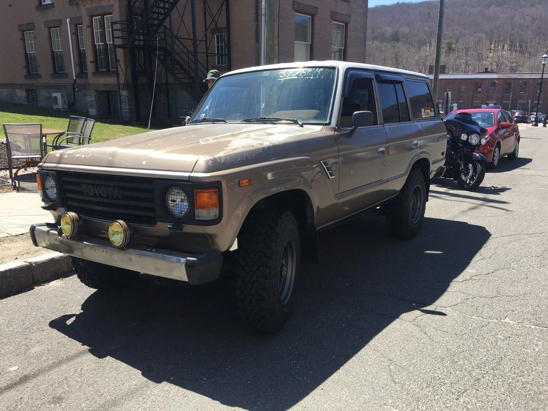

Hello all,
My Uncle has a 1985 FJ60 that he's holding for us (we won it at auction) prior to (hopefully) driving it out west. He's not particularly mechanically savvy; I'm wondering if there is anyone here who lives near Newburyport that might swing by and take a look at it prior to him gearing up to drive it west? Happy to give someone a 5-year complimentary subscription to the magazine and some bevs to take home!

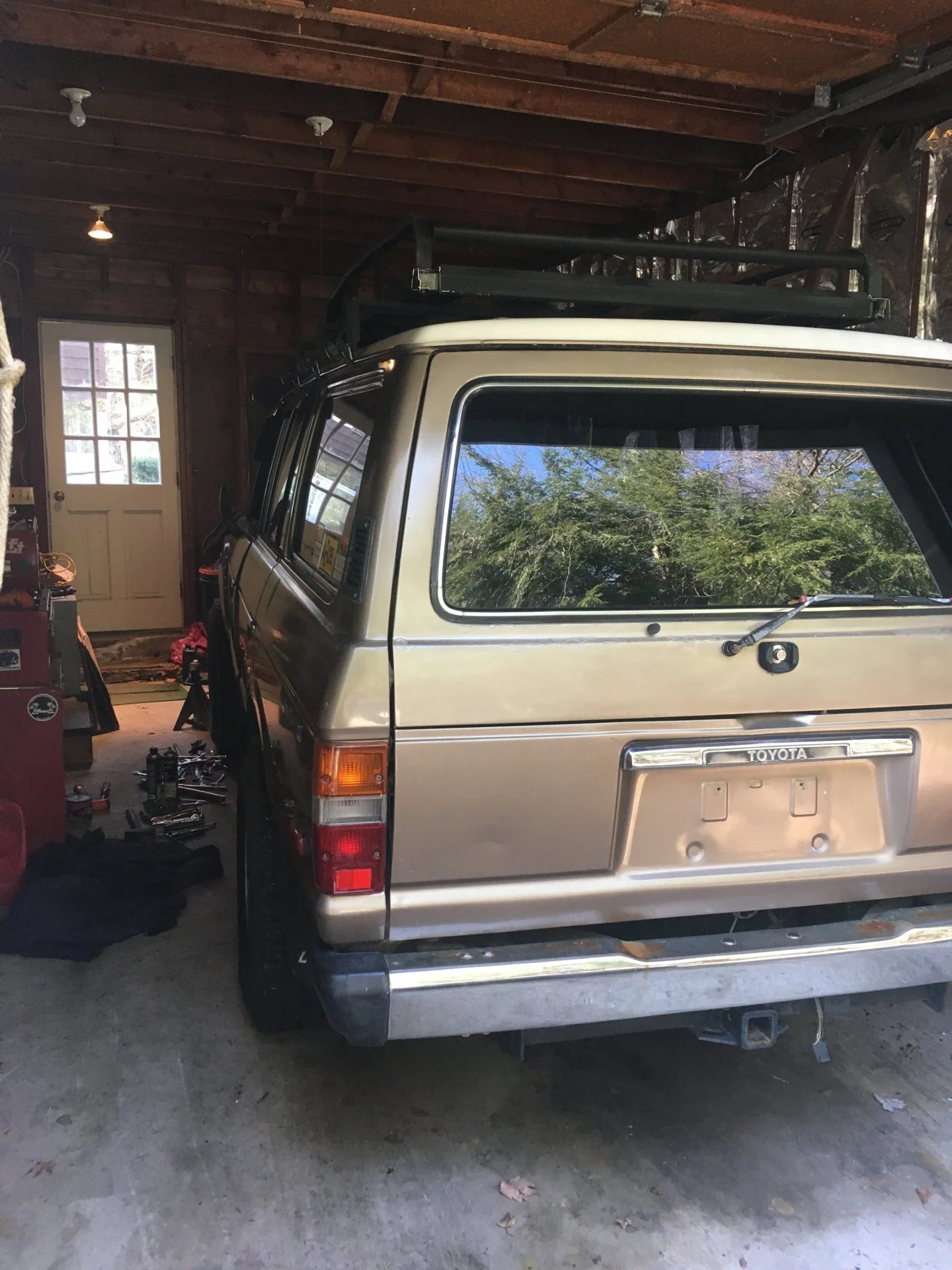

Update- Land Cruiser Love Shack picked up the 60 back in the winter, pushed it onto the trailer as I killed the spare battery I had brought trying to get a 40 running I was going to buy and grab before heading to Nport. Passed that one off to Dufault, Who graciously lent me his trailer for this journey.

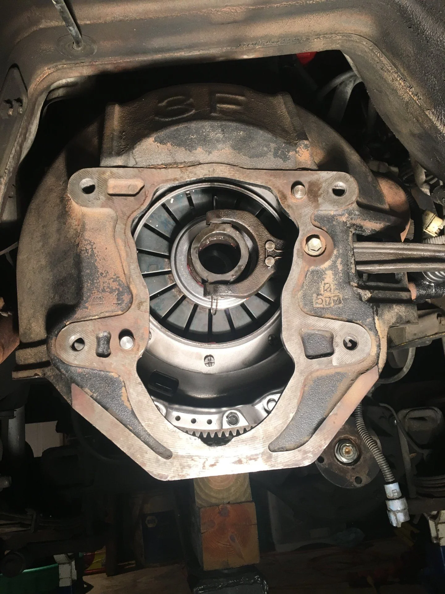

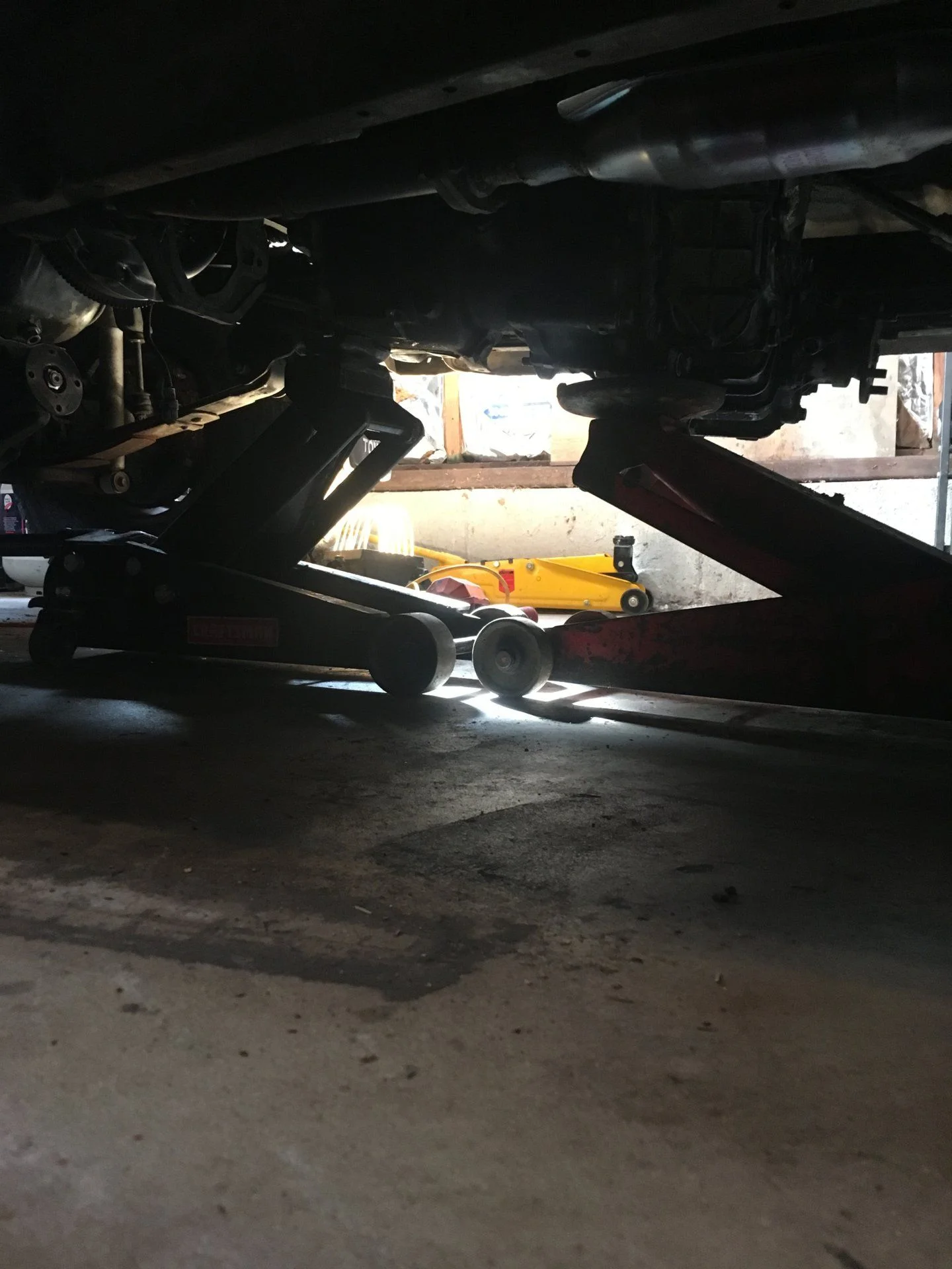

Swapped batteries at home, a few drops of Petro in the carb and she fired right up! Yay!!!! Ok, let’s move her. Oops, clutch is shot. Park for a few...

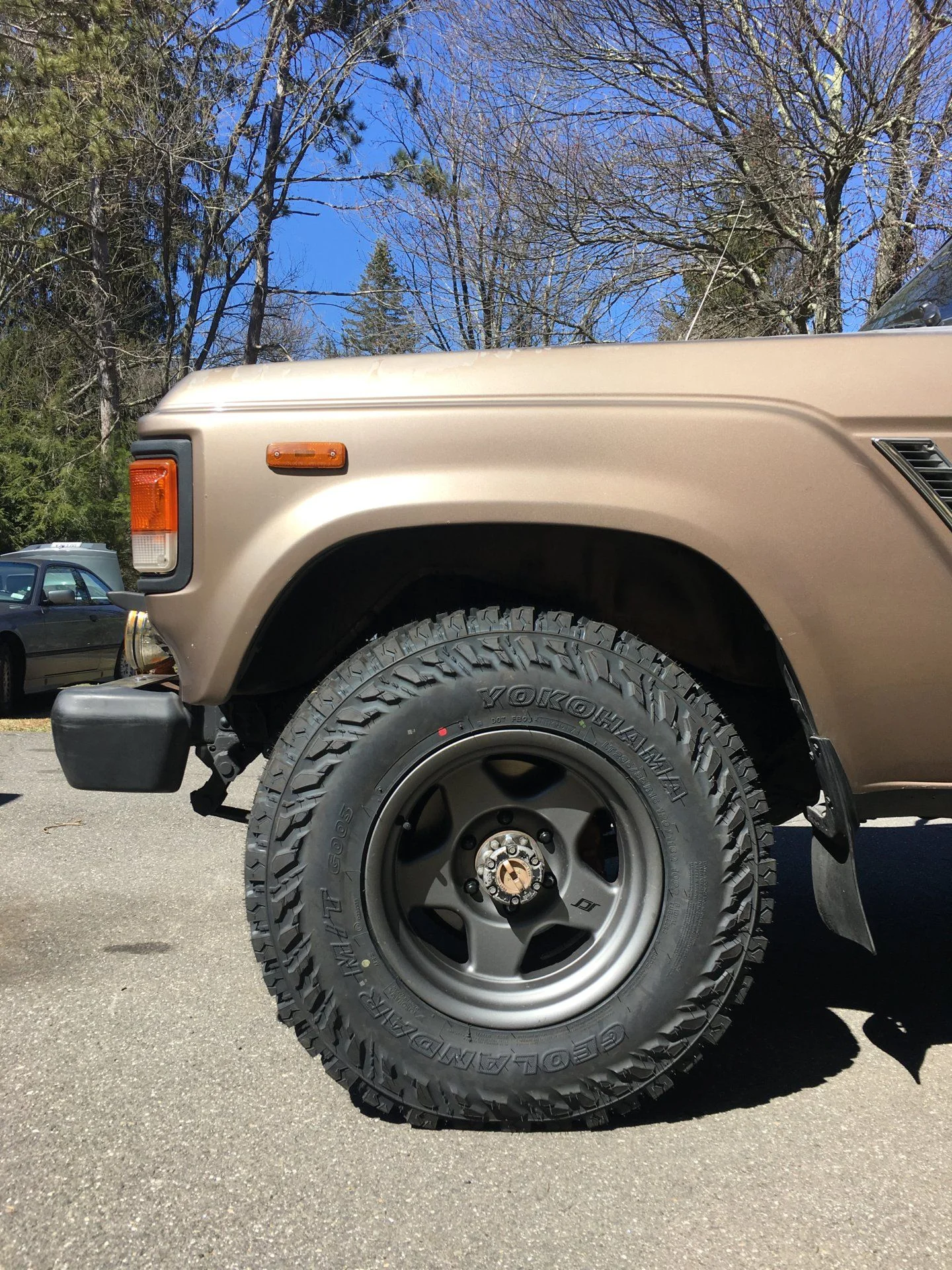

Guess that means it’s time to organize garage...... long story short, she’s now got a new clutch, master, slave, OPG, PB (no J) (lots for me though), RMS’ed, new rims and tires from _________, 4WDTOMag, carb rebuild and frontwbd rebuild on tap next week.
This truck is amazing!!! So so so stupid clean, bolts actually come out, 397k and it runs like a brand new pulling tractor should. I’ve beeen blessed and honored to work on it, along with so so so much more to come........ I love these trucks and love you dudes.
