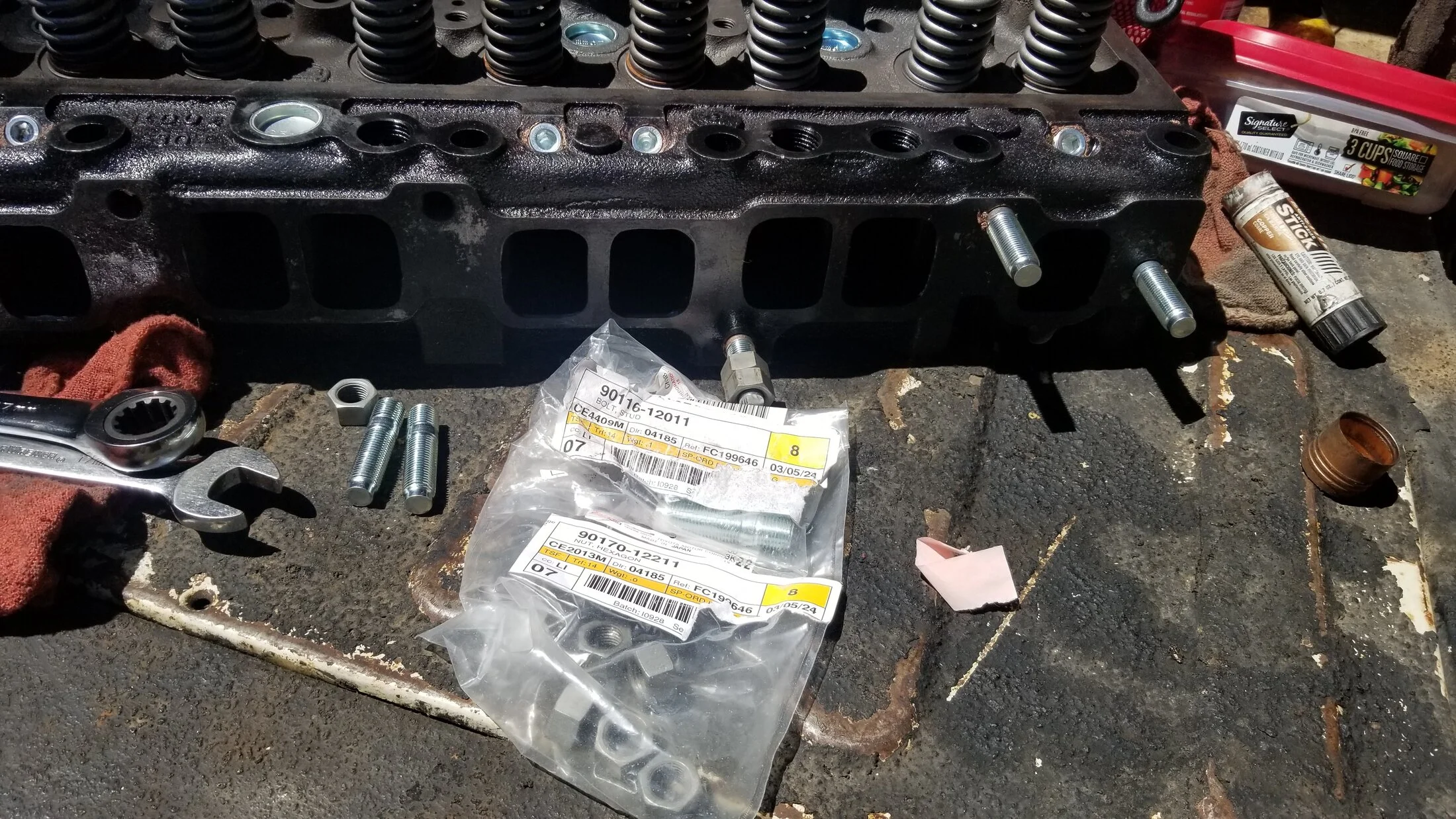

I do not use bolts there, I use official Toyota studs, nuts and washers. Anti-Seize on both ends of the studs. Sometimes those studs break and have to be removed. I replace all the studs and nuts every 3 or 4 times that I R&R the manifold/header. I tried the Remflex gasket once, it didn't work for me at suggested torques nor at higher torques. Now I use the Fel-pro gaskets, I've used two at a time in some cases. After some machine shop time I'm down to just one. I routinely snug up those nuts, I might even exceed the FSM recommended torque by just a little bit sometimes.

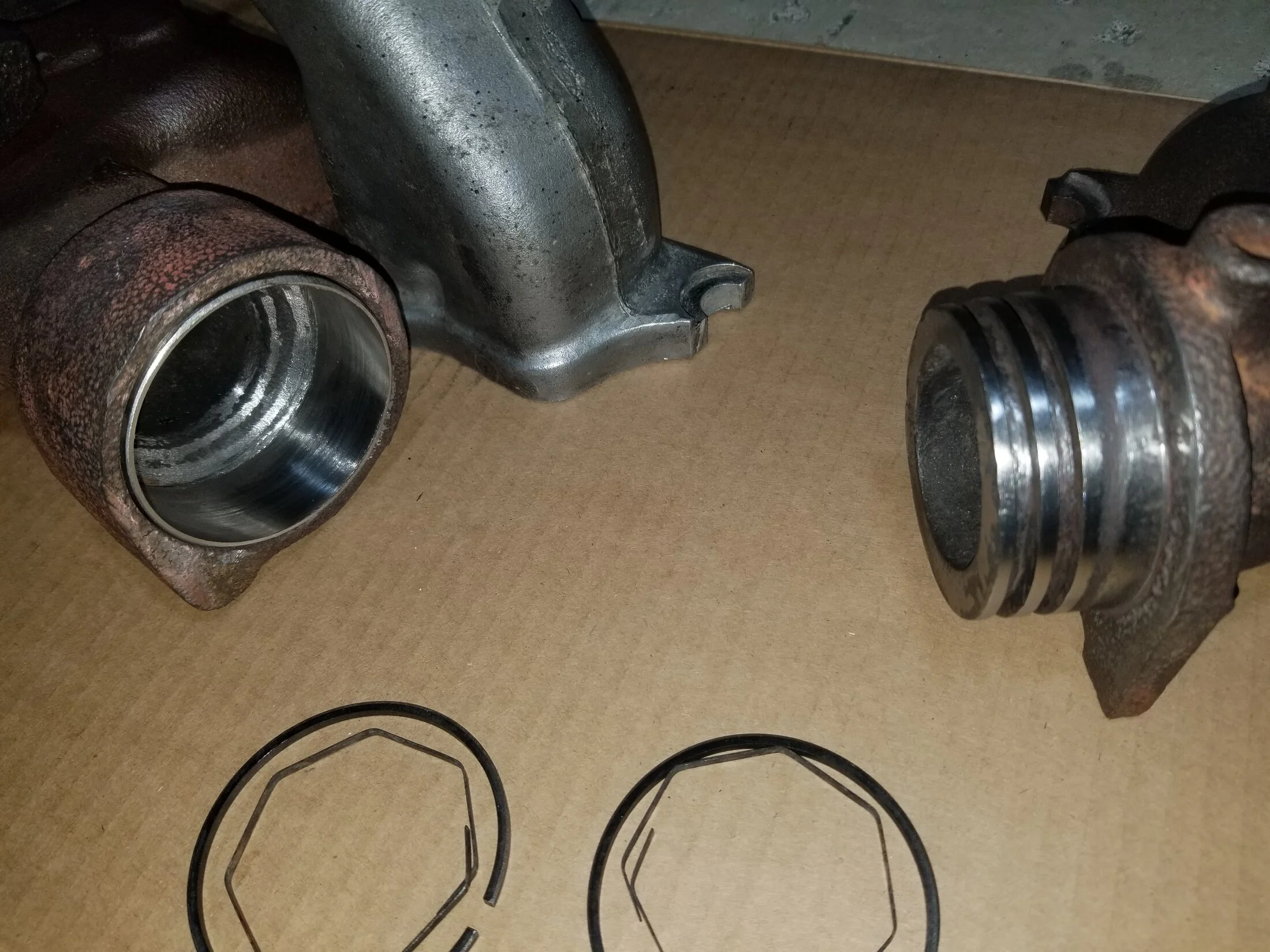

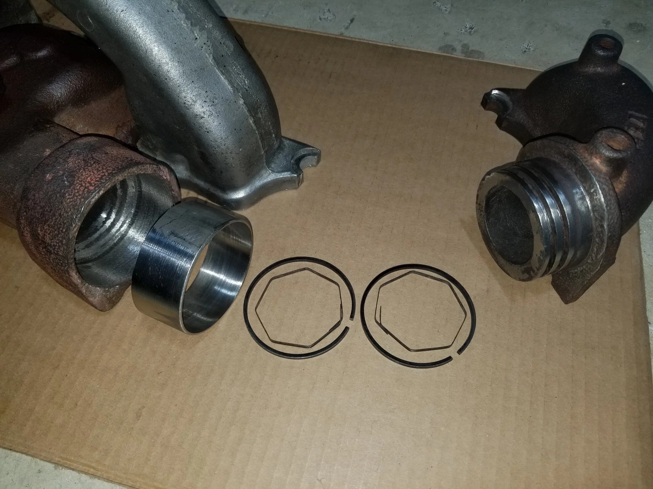

Thank you all for weighing in on my question - I realize I may be overthinking this, but I've put a little extra work into the manifold this time around and I didn't want to make any wrong moves or miss something at this point. The truck was suffering serious manifold vacuum leaks and really needed attention so I pulled the manifold and carburetor off and cleaned them up. (rebuilt the carb, too) Did a little sanding of the manifold on a piece of glass (well within limits), however, the cylinders on the ends of the exhaust manifold that the horns (with rings/springs) go into were really corroded - to the point that the rings were not seating at all. A machinist friend of mine fabricated stainless sleeves and honed out the cylinders to receive them - now the rings seat nicely. I threw in a couple of pictures to show you - off topic, but might be an option of some interest to others with the same problem. Anyhow, your insight is valuable to me and I'm grateful you've taken the time to share it. I won't be able to install the manifolds until the snow stops falling so if you have any other observations/advice that come to mind, I'm listening! Thanks again.
